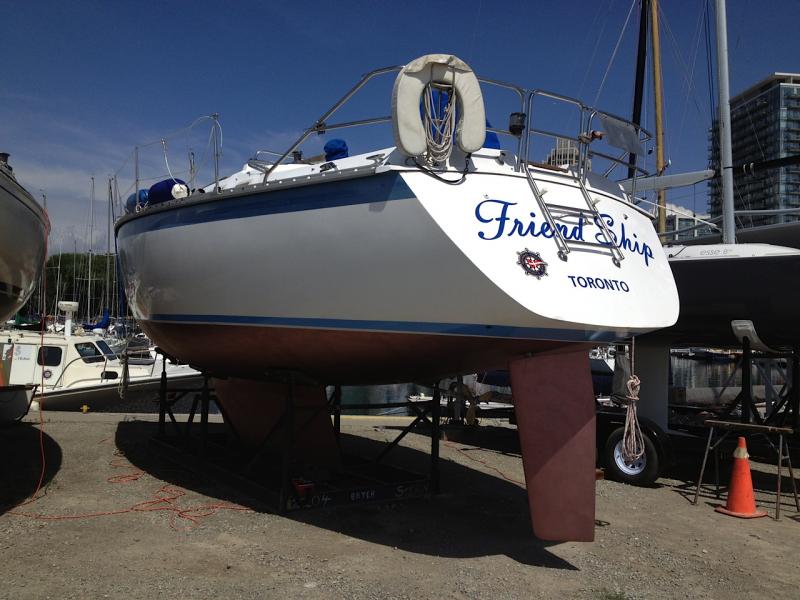

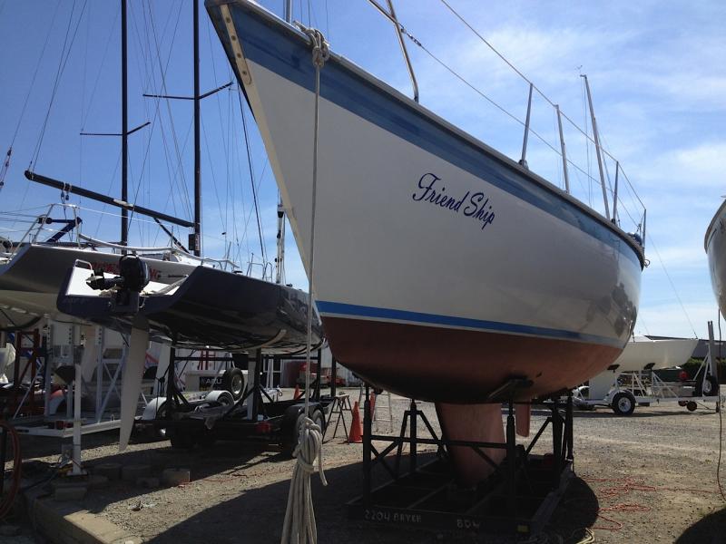

A job that is all to recent in my mind!. I just finished the iron keel and the bottom of our H34. The keel needed work and I decided that seeing as the boat was out, I would do the whole bottom.
I stripped the keel with a needle scaler, which got most of the rust and old fairing off. The only thing it wouldn't budge was the POR15 I put in places 3 years ago! After the needle scaler I went over it with one of those impregnated fiber wheels that they use to strip auto paint. Dusty job. Then I coated it with an industrial rust converter ( probably phosphoric acid based. Then I put one coat of Interlux 2000 on. Faired it, then put 4 more coats on. The hull got 4 coats also, after striping the VC tar with a heat gun and scraper- the part I paid someone else to do. Then compounded and polished and waxed the topsides, painted new bottom stripe, put new name on stern ( same name, new letters) and a coat of VC17. Here is what it looked like at launch Aug1.
