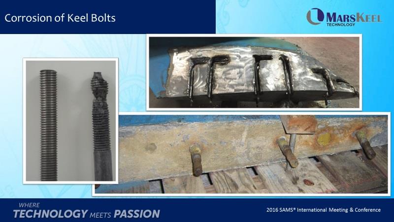

I've no experience doing this, but I would suggest that if the caulking is 44 years old, then those bolts have never been inspected properly, since the keel was first laid. You might want to pull each bolt and fully inspect them, not just back them off, caulk and return. There is a lot of information on the Internet about keel bolts that look great until they are actually pulled. Then, it is found there is very little bolt actually left inside the keel.
