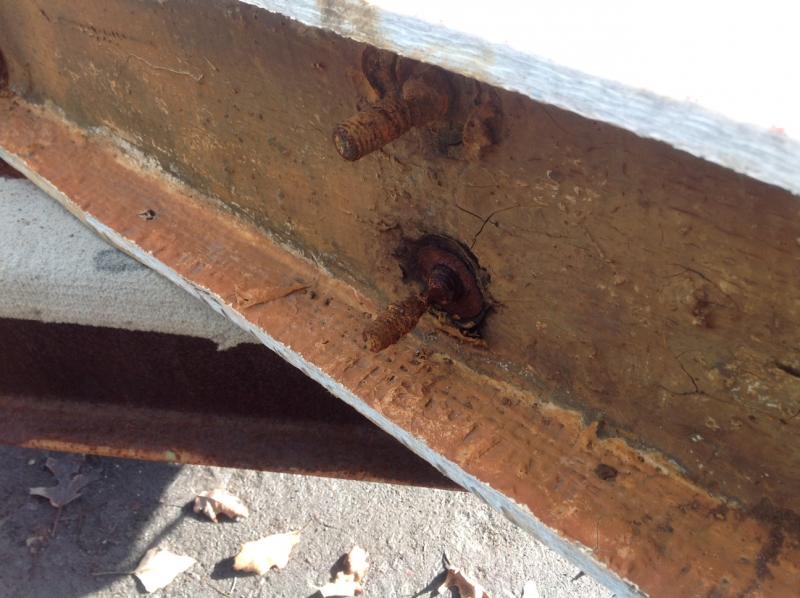

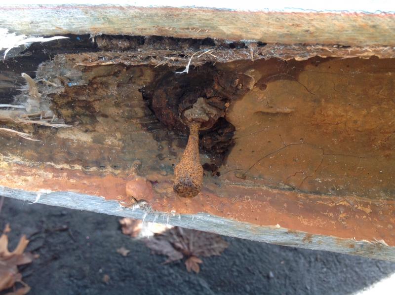

I was walking through my boat yard today and came across this keel laying on a dolly. I snapped a couple of photos of the keel bolts as a reminder to everyone to protect your keel bolts with proper maintenance. That little trickle of moisture coming from a hull to keel joint may be the makings of a really serious issue. This is scary stuff. Stay safe.

Looks like a plywood cored keel stub..... Can you find out what kind of boat it came off...? From the looks it appears to be a Catalina from the 70's though it could be a Pearson from the same vintage or one of the many other builders who use plywood in the keel stub......

If you look carefully at the pictures the keel was cut off which is strange. Doesn't look like the bolts failed although they look horrible. A few years back an O'Day 30 or 32 lost its' keel. I was the series that had the gray hulls which were poorly constructed. You could easily move the keel back and forth when the boat was in slings. The keel bolts didn't fail but the hull above the keel broke clean off. It was amazing how poor the construction was. The keel and bolts came off in one piece. The hull was no more than a 1/4 inch and that was all that was holding the keel on. No grid or cross members. Pretty scary stuff.
8,158
Of the boats that I personally have seen the keels come off, all were the fiberglass hull to keel that failed - not the bolts. In other words the keel came off with part of the hull still attached. Just saying ...
