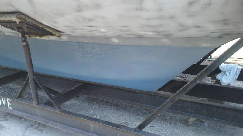

Hey JC, the stub is thick but how thick? Close to the stub, where my engine water thru-hull is located, it is about 7/8". I have the plug to prove it. But that stub that the keel bolts come up through has to be much thicker. I am talking about the vertical part above the hull to keel joint in the picture.

Sorry, Ed-- I don't have that sump-like 'stub' as you called it; but I was referring to the 'glass skin to which the keel actually bonds. I guess we both figured out what the other meant.
