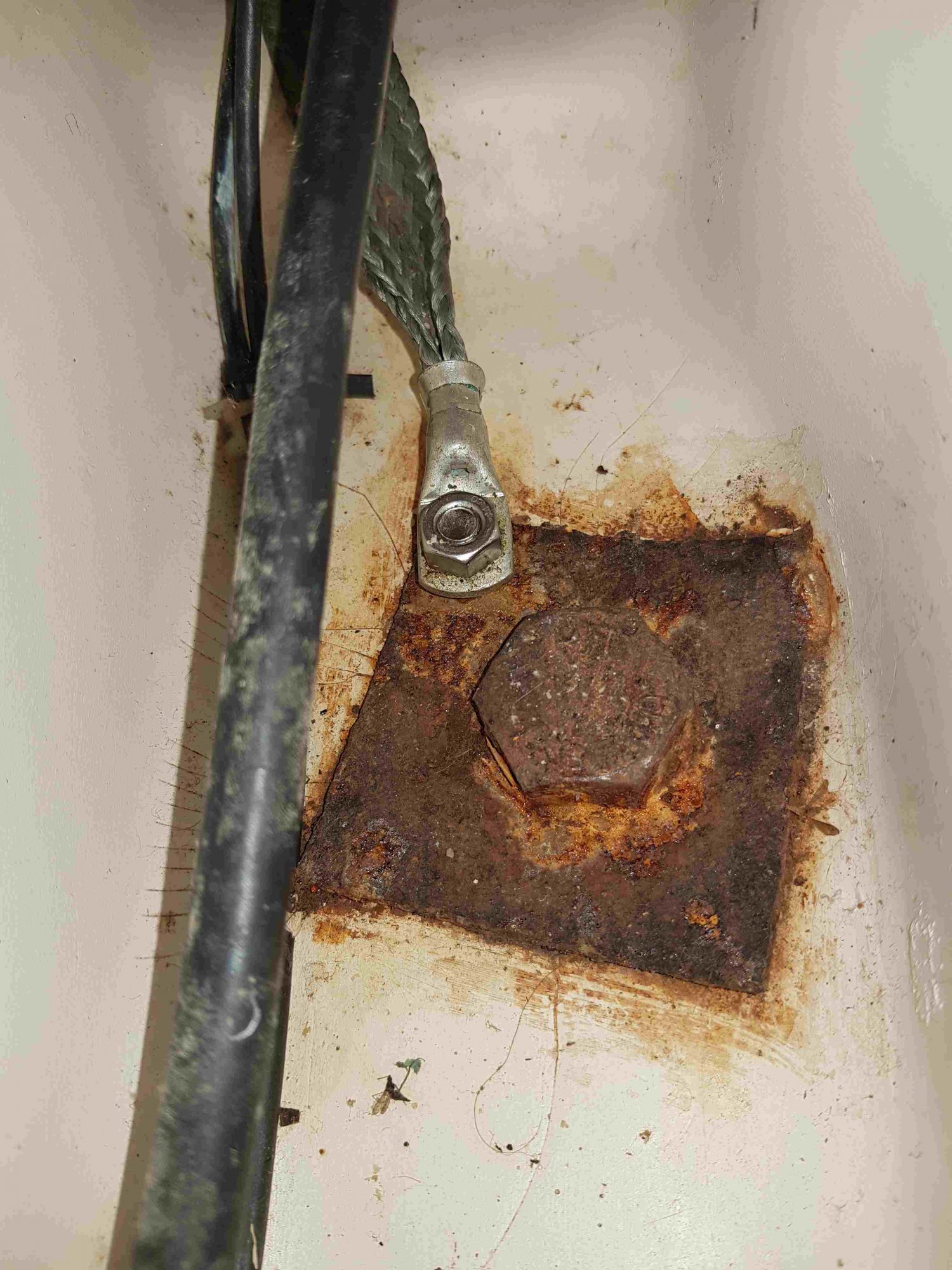

Hi, I am delighted to join the forum. Probably I will become new owner.
I am looking to buy an Oceanis 400 in Italy. I found boat. I checked most of the boat and I found partly rusty keel bolts. The first one is rusty. The boat is year 93. Do you see this as a bigger problem? Is this normal for this type and old boat or it is something specific for "almost my new boat".
What are yours experience?
Regards,

Not a Benny owner but I think the problem you are looking at are steel washers under stainless steel (SS) bolt heads. All except the first one where both the plate and the bolt are steel. The steel washers will need to be replaced sooner rather than later because the bolts will become loose as the washers corrode.

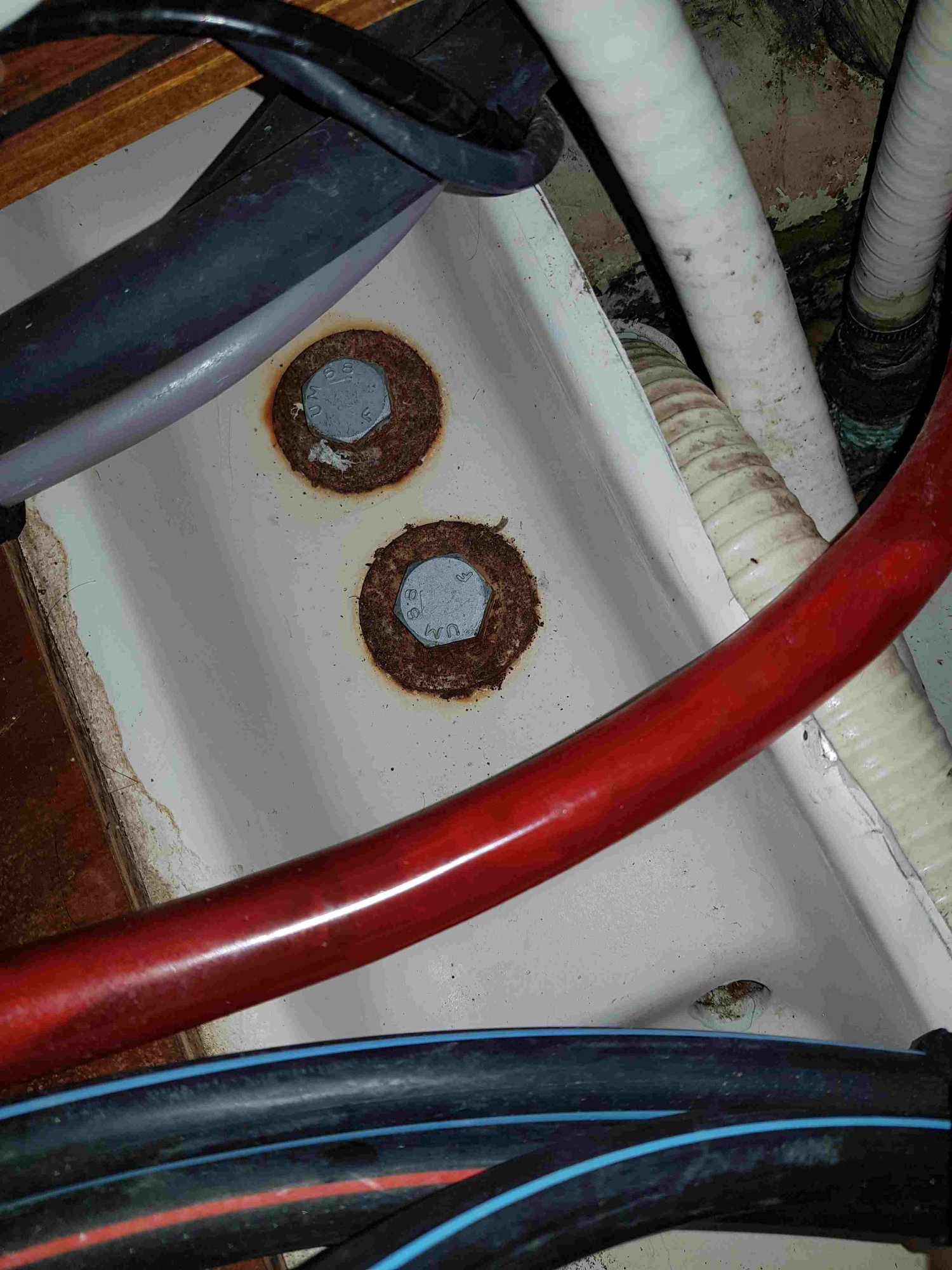

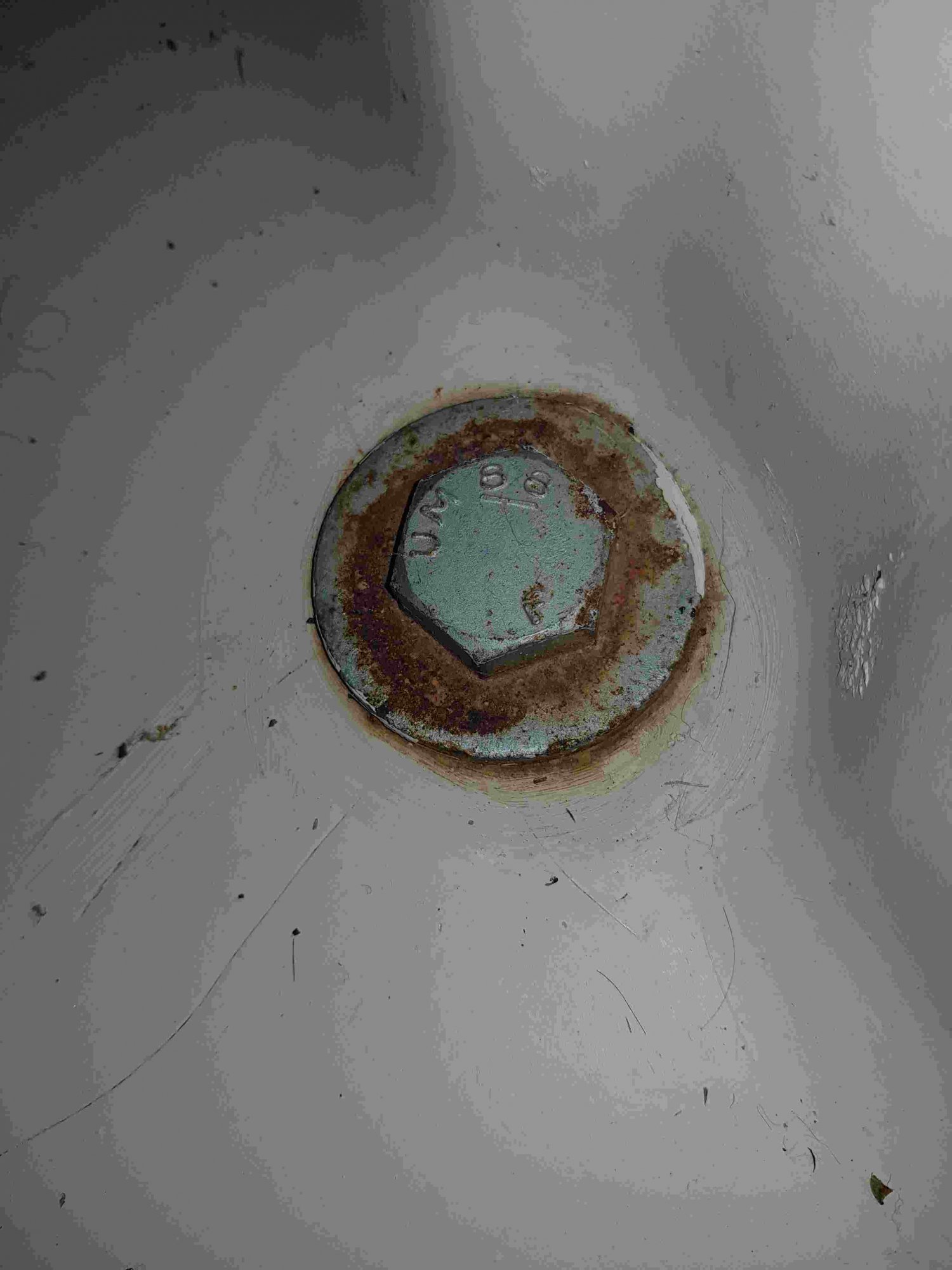

A few comments- The rusty bolt still has its bolt head shapes so it hasn't been too long (probably not original from '93). The other two bolts appear to be hot dip galvanized. None of the washers are galvanized. On my boat, the washers are square and thick and stainless steel. From what I've read, the bolts can/should be replaced periodically- you can get the bolt spec (thread pitch, length, diameter) can be obtained from the owners manual.
One question is where's the water coming from? Leaking thru the bolt heads from outside is a bigger issue but (IMO) not a show stopper providing the price is right.
As you can see, the grounding connection also needs attention and good contact.

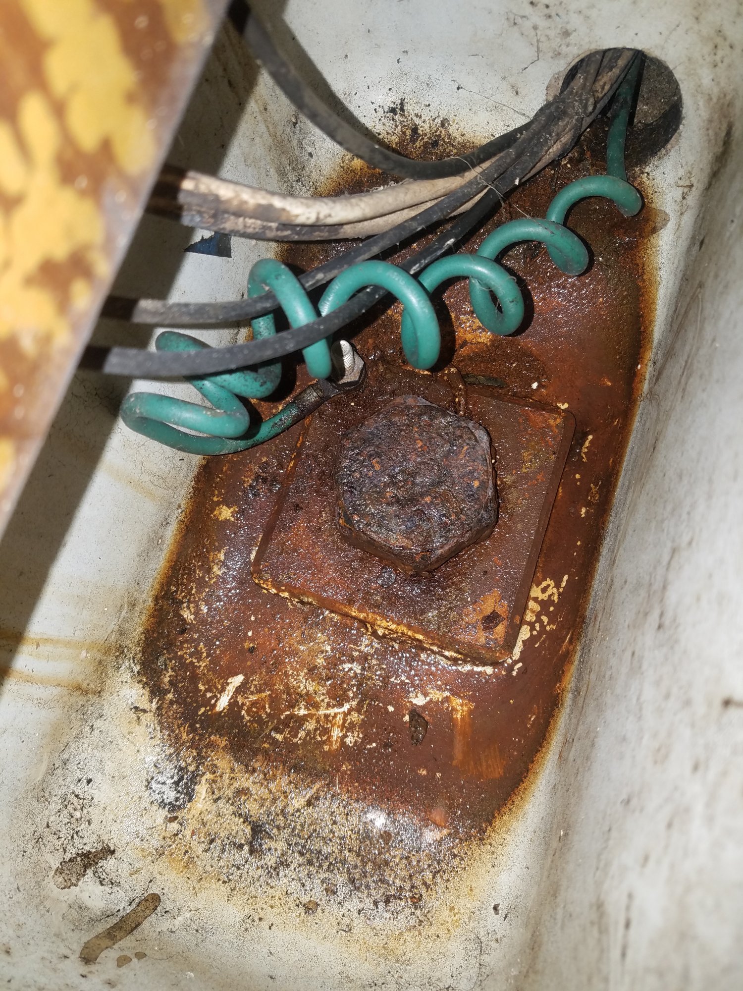

I had the same issue on my '93 Beneteau. Below is a pic of the bad bolt. It was not a big issue. Both me and the surveyor missed it when I bought the boat. The water runs down the mast and collects in the bilge where this bolt is located. The limber hole is too high to drain the water unless the boat heels. My other bolts also have plates under them not washers. Your other bolts don't look original. If the boat is on the hard, have the seller change them or give you a credit. I tried to replace it myself but ended up having the yard do it. The tools and time required did not make it practical. The yard charged me 4 hours labor- they needed to remove some furniture to get to it. Beneteau does not use bolts anymore, they sell studs with double nuts to replace the bolts. I paid a lot for that one stud, over $200, they can probably be purchased a lot cheaper elsewhere once you have the specs. Also attached is a beneteau write up on the bolts.

All valid points. I just thought I'd share the source of my pdf. Believe it or not, not everything you read on the internet is true. I would stick to galvanized bolts/studs in an iron keel. I never considered what stainless might do to the threads in the keel. I find bolts are easier to remove and install. The yard had to grind down a Crowfoot wrench to fit in that recess in order to back off the second nut when installing the stud.
