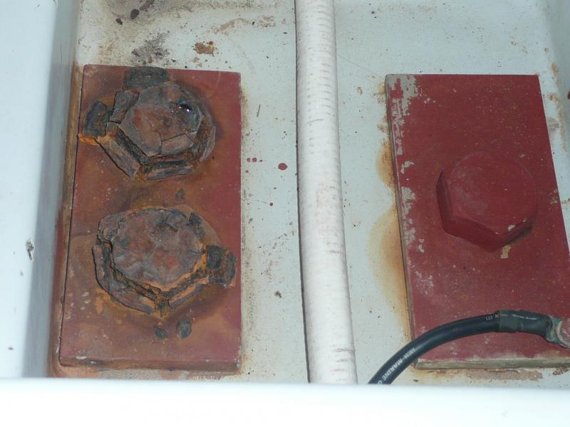

I'm trying to find out about keel bolts for a 1988 432 Moorings boat.
I bought this boat after looking at my survey. It was noted that the keel bolts had rust on them. After looking on the internet it seemed like this was a normal thing and not something to worry about. So I bought the boat.
Now that I own the boat, I have looked at the bolts and it's not good.

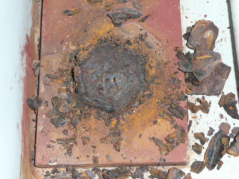

2 of the bolts have lost the top of the bolt. It's a perfect bolt top after pushing hard with my finger. It just fell off. I was planing to just twisting them off and puting a new bolt in. That's what I thought would happen.
Now I'm not sure what to do?
Has anyone drilled and extracted the bolt in the water? Is this a bad idea?
Should I just pull the boat out and do it on the hard?
I have tried to contact Beneteau but, no one has responded.
I want to buy new bolt's but not getting anywhere with with the Beneteau web site.
Don't feel like I can order and get the right part.
If you have any history of what to do? Or who I can contact?
You would be my best friend!
Thanks

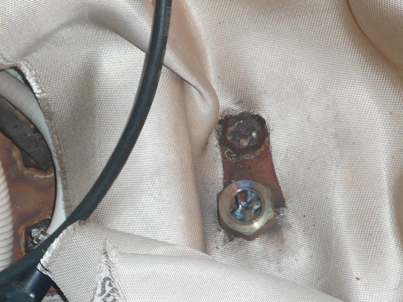

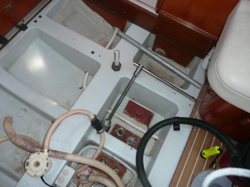

I have a '95 42S7 and experianced very similiar problem.. What i did (in the water) is after removing all the corrosion there was nothing left for a wrench or socket so i welded new large nuts. After that i was able to remove and get them sized. replaced one by one..

I'm not sure I have enough left of the bolt to weld to?

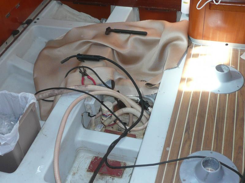

All of this was accomplished in the water...

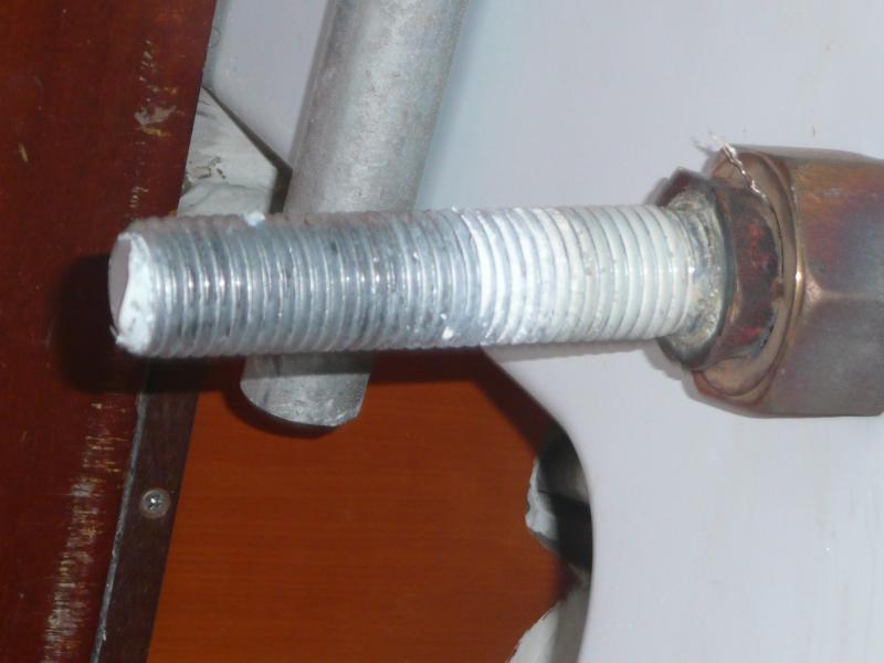

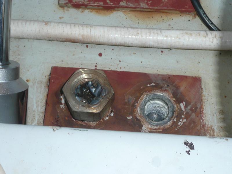

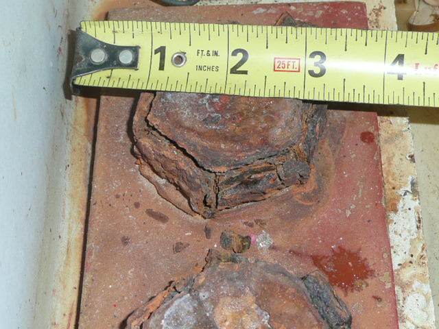

Enclosed are a few more pics that will show what i had left of the bolt for weld attachment.
Note that i welded inside the nut (and i am a crummy welder) so if you have less material than the inside of the nut then your keel probably fell off already. <joke>
Did not try an extractor, might work.
maybe because of the heat but they came out with lever bar roughly three foot long much easier than i expected.
They all had a white sealant existing in the thread i did not add any more.
The last plate had lightning ground attached to it and coincidentally had no corrosion...
