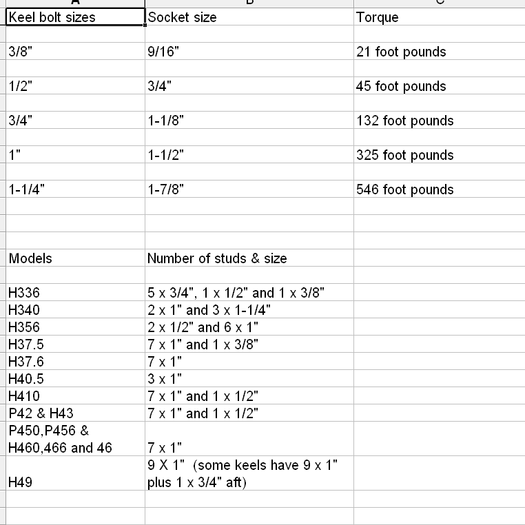

Hi,used the info on the documents section to tighten my keel bolts. Double checked the bolt size and torque. Now getting water seepage into the bilge and nervouse that it might be from them. Anyone else used those docs to tighten keel bolts?

Those are the ones if they look like this. Hunter sent these to me decades ago.
They are the max. allowable stress (including the factor of safety) which the bolts (j-bolts, whatever) can safely withstand without the risk of plastic deformation.

did this work with your 310? we used this using socket size info. for our 290. Not sure where the seepage is comming from. Checked fresh water , hatches etc, bildge.

These are the maximum allowable torques for SS bolts which can be found in any technical handbook and to more conditions than you want to know.
