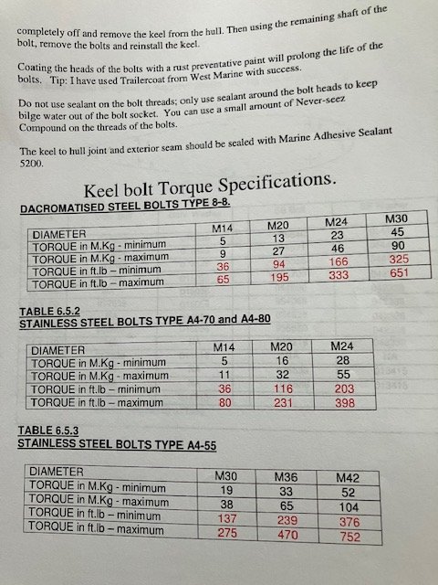

Have had this table in my files for several years. Don't know exact reference / source; however, it pertains to Beneteau boats.
