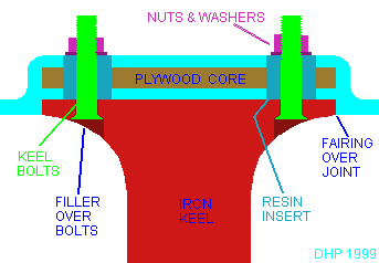

Has anyone here ever replaced keel bolts? Below is a cross section of the keel construction of my Peason P26. In my mind I feel like this is a simple job.
1. Bust the rusty nuts off the top.
2. Hammer down on the top bolt with a 5 pound sledge, hopefully that reveals where the bolts are from underneath, excavate the bolt head from below (if not take careful measurements and find them.
3. Replace the bolt.
4. Move on to the next bolt
5. Reseal everything
In practice I doubt it is that simple. Just looking for some tips from anyone who has ventured into this.

Where did you get the drawing? How certain are you of its accuracy?
Most keel bolts are closer to the center of the keel and not the flanges. Often they are threaded into the iron.

I am gauging whether or not I want to even try it. In theory it sounds simple but I think in practice it is going to be much more difficult than I think, in practice seems like the bolts are going to be an absolute SOB to get out.

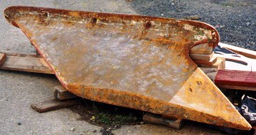

I got the drawing from Dan Pfiefers website. Here is a pic of the keel off
14,166
Have you removed any nuts? The bolt may be in decent shape, in which case just replace the nut and washer, a much easier job.
On the other hand if the bolt is rusted too far, then it is time to replace them.
Since you know about where the bolts are, remove the bottom paint in the general area, you should be able to see any fairing compound. It will be easier to Dremel the fairing compound out than to beat the bolt out. Finesse is often a better strategy than brute force.

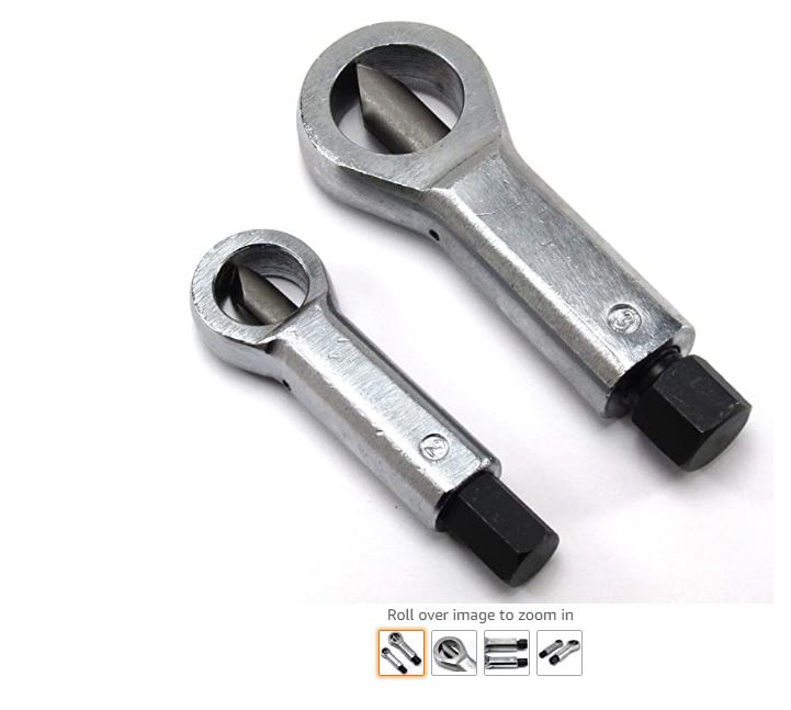

If there is room, try using a nut splitter to spilt the nuts that will preserve the bolt.
Bolting thru a molded flange is pretty common for cast iron keels; I have seen this on other makes of boats up to 42 foot.

I remember considering this on my P26 a long time ago. In the end I only had to do the nuts. Try looking for a nut splitter such as the one shown. If that fails, I drilled a hole(s) vertically next to the bolt (its OK to leave a little steel next to the bolt just don't hit the bolt threads) Then move outward and drill away more nut steel then grab with a pipe wrench and turn and the nut should split. If it can't be turned or is stubborn at this point you can use a SHARP cold chisel to remove MINOR nut connections with care- you don't want to damage the fiberglass.Capture.JPG
