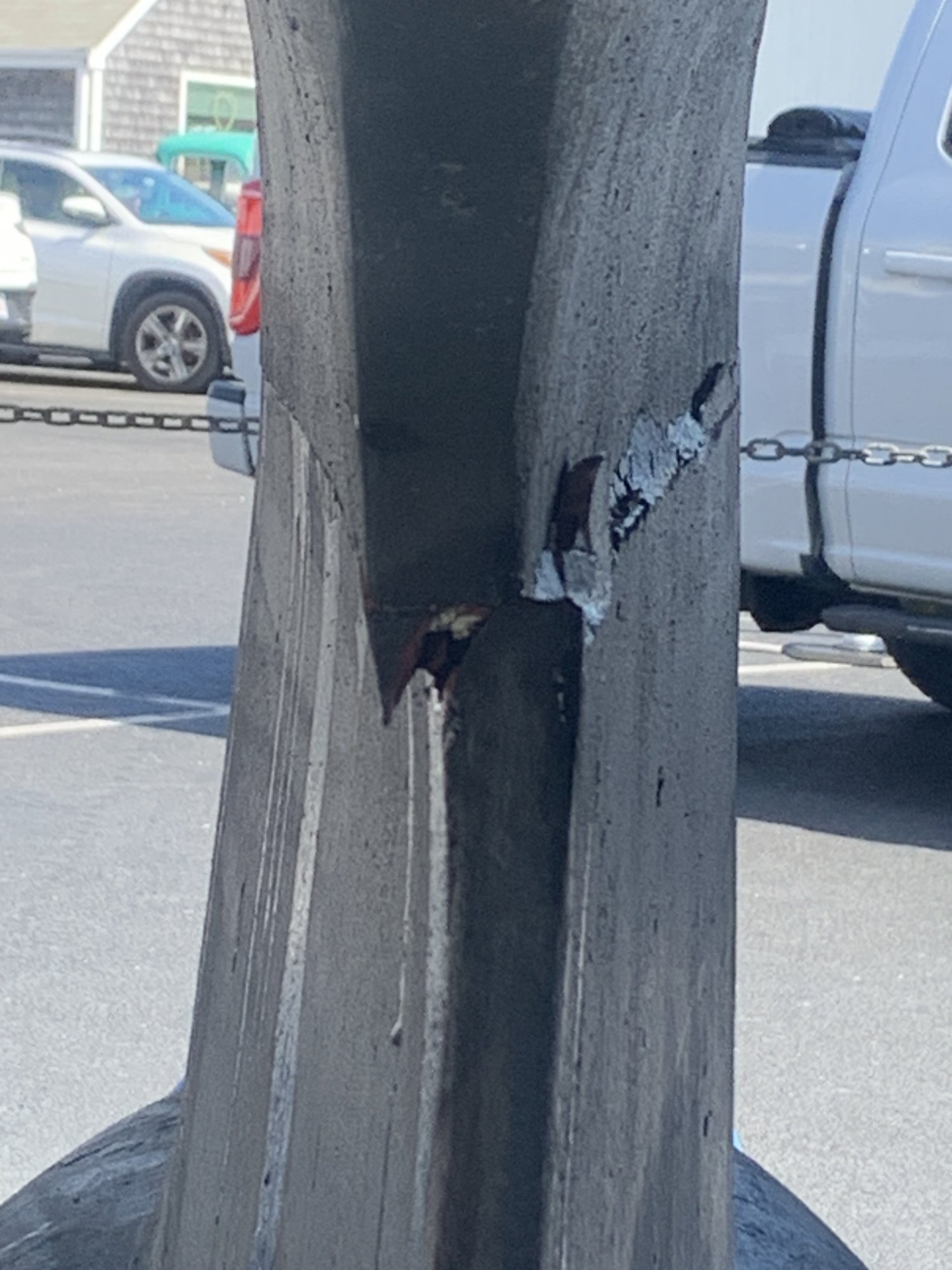

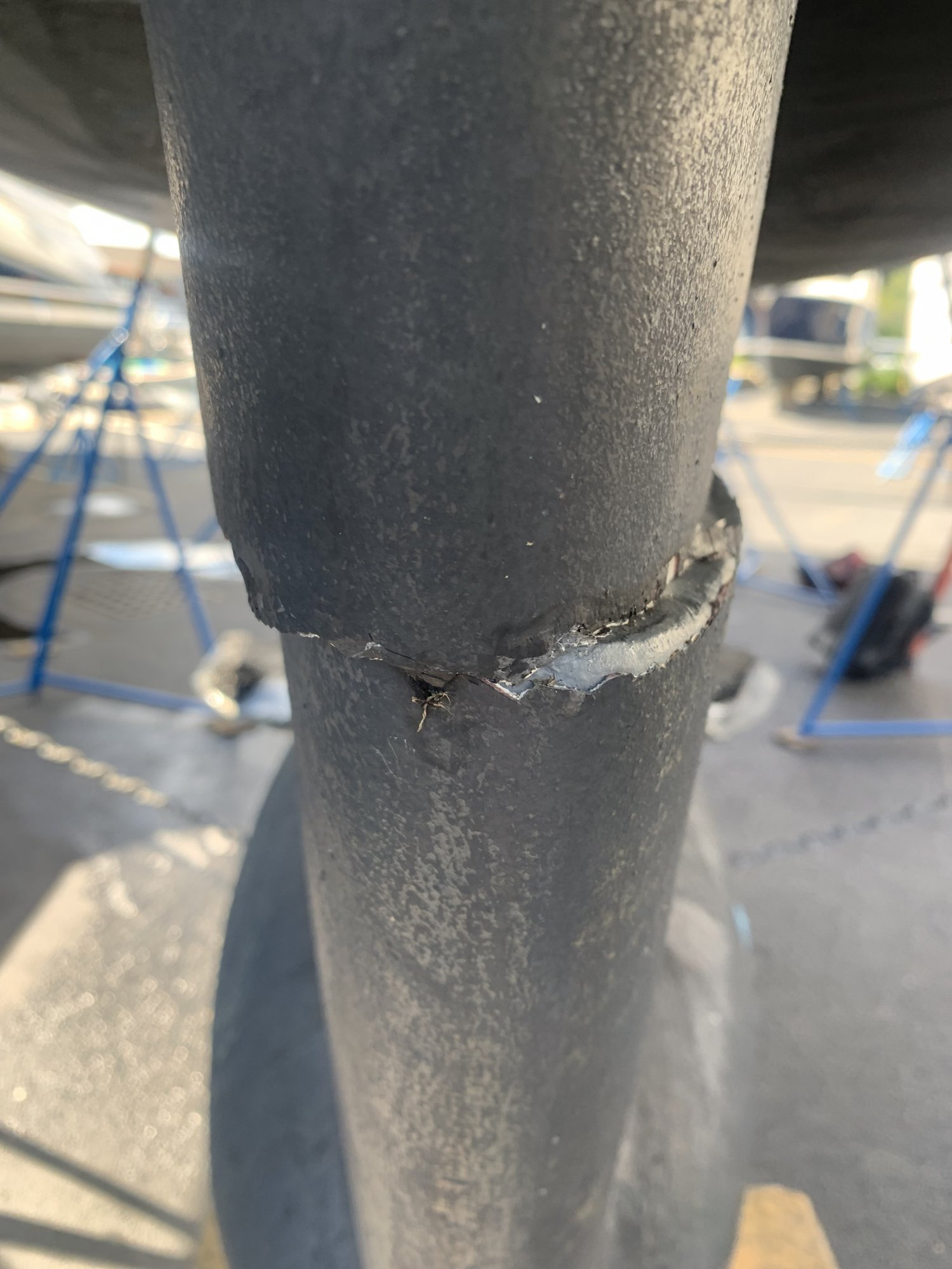

I sustained damage to my keel recently. I hit a rock in Robinson Hole passing between Vinyard Sound and Buzzards Bay. The keel got twisted 2-3 inches off center. Water leaking into bilge such that pump ran every 20 min at rest. Boat was hauled at SouthWharf in Massachusetts. The keel repair operations they use are 1 no longer in business or Mars not replacing keel bolts at this time.
i have contacted at least 20 yards in the area. Not one of them was interested in taking this job.
it is my understanding that melting the lead and inserting new bolts is best repair method. But it is acceptable to sister in lag bolts is an acceptable option, also it is possible to cut a window into the lead and thread a rod into this area from the top and create a replacement keel bolts at. What say yea boating community?

With an impact so strong that the keel moved, it is quite likely there is more damage to the boat than just the keel bolts.
There is large possibility of more structural damage to the hull and interior fittings as well as the keel sump itself. Have you contacted your insurance company yet? Any repair will be quite expensive.
The keel needs to be dropped. The keel sump needs to be carefully inspected for damage, especially around the bolt holes.
If the boat is worth repairing, new keel bolts can be installed by sistering in new bolts. To get an idea of the work involved, watch this series of 4 videos on Sailing Uma about how they reinforced their keel sump and installed new keel bolts.

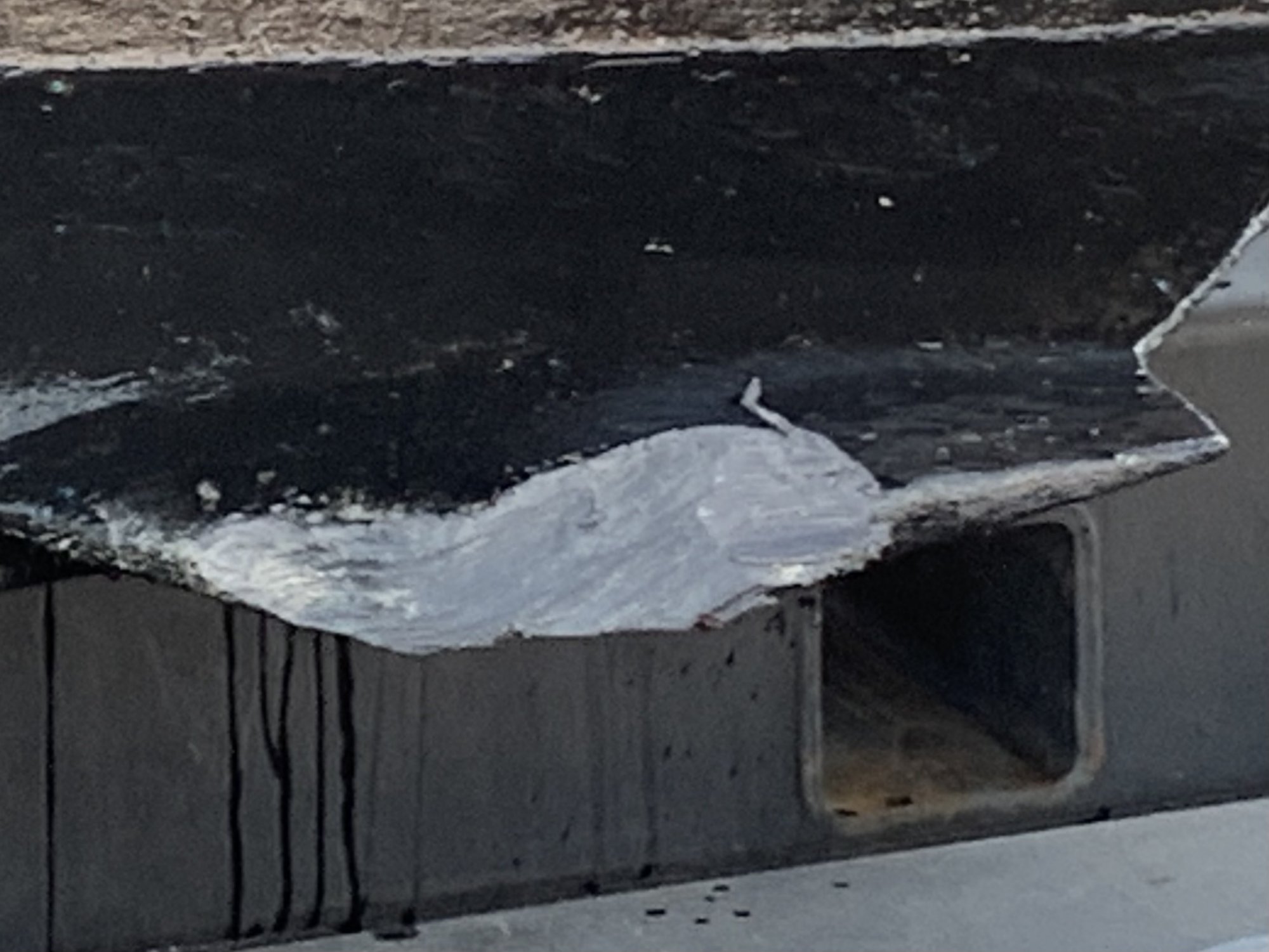

We are speculating the keel bolts need replacing, they may not. The keel weighs in at 7,700 lbs, the keel bolts should be fairly substantial, I'm guessing at lest ¾" or 1". It would take a lot of force to damage those bolts or even loosen them in the lead. A more likely scenario is the force damaged the fiberglass in the keel sump, effectively enlarging the bolt holes in the hull. Photos of the bilge and keel bolts would help.
The level of damage to the keel indicates the need for an onsite survey by a qualified marine surveyor. If the boat does not have hull insurance, the cost to repair it may well be beyond the owner's ability or interest in repairing it.

The image shows a significant displacement. As @dlochner says - it really needs to be looked at by a professional.

Has your insurance company sent a surveyor to assess the damage? I'd be surprised if none of the glue joints between the hull and grid have separated.... Surveyor should be crawling around with an inspection camera getting into all the nook and crannies... The Plexus adhesive used to glue the grid to the hull is plenty strong but it has limited elasticity, thus it can separate from the substrate.

When the keel comes off, there's a real possibility that some glass will come off with it, it's not usual to have to partially rebuild the stub before dropping the boat back on the keel. Oh, and the mast has to come off.....

Were it my boat, I would drop the keel and investigate the grid structure before any repair was decided on to make sure that the problem is the bolts and not the hull and grid structure.
