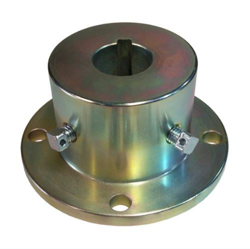

I believe mine are safety wired if it's the bolts from flange to shaft, similar to that seen below?

flange to the trans
