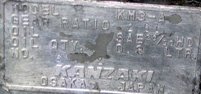

A sailing friend has a significantly faster (bigger) boat. I thought I might try to even things up a bit with a folding prop, but the prop company not surprisingly wanted to know what my transmission's ratio was. It took some paint stripper to get down to it, but it is 2.61. While uncovering that, I also discovered that it's a KM3-A, not the KM2-A one usually - or so I thought - associated with the 2 cylinder Yanmar. Is this an unusual pairing and, if so, any cause for concern? I noticed that this is the middle ratio of the three offered and is the only ratio that has a matching one on the KM2-A. The engine does seem to be able to reach its maximum RPM (or close to it) with a clean prop.
Of course, it did occur to me that this might make the upgrade to a 3GM a bit easier!
