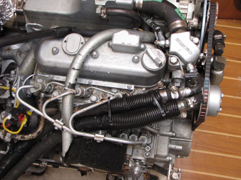

Alansails
I saw this K&N filter on the Catalina 34 site in 2008, it was being used on a M 25xp, the id of the inlet fit the stock od manifold intake.........so easy peasy japanesy and it fix my problem.
I gained 10 SAE HP with this modification.

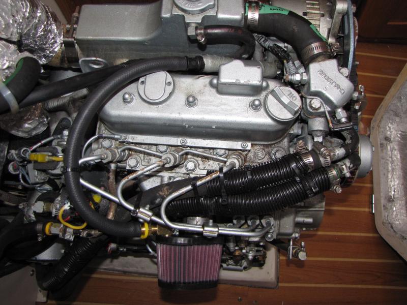

The suction problem seems odd. There should not be too much suction pulling through the crankcase breather hose since the filter has so much surface area from which to pull air.
Also, make sure the hose fitting (I used a pvc elbow) is tightly clamped to the hose. If it were to get sucked in, the result would probably be catastrophic!
My M18:

Also, I'm hoping to do this upgrade this weekend and I'm a little confused still...
In connecting the crank case vent to the filter, could I ask for a few more details please?
PaulJ it looks like you just cut the vent hose and somehow attached another hose to the Cut end?
Then you attached the new hose to the fitting you put into the air filter? Do I have that right?
If that's the case, what did you use to cut and modify the vent hose?
What size hose did you use? Is it the same size as the vent?
This has been asked I think on the older thread but where did you get the fitting that goes into the air filter?
How did you attach the fitting to the air filter?
It doesn't look like you used hose clamps?
Sorry for the interrogation :( I just didn't see these details in this or other threads on this topic.

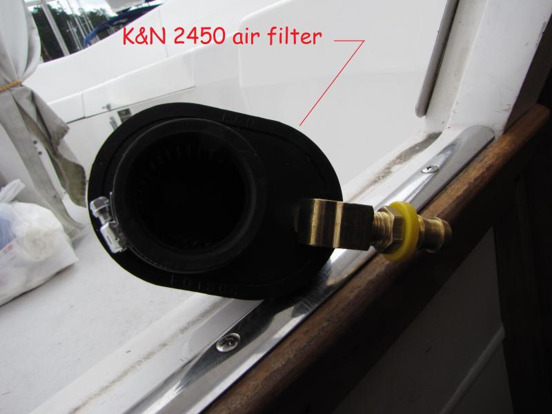

I cut the original vent hose, after the the bend, then went to a Napa dealer with the old vent hose..... which had the K&N filter and said I need some parts to make this thing work with these parts............she dinked around for about a half an hour and came up with the parts.
I drilled a hole in the filter housing , a hole smaller then the fitting tread size, then screwed the fitting in with a wrench.
