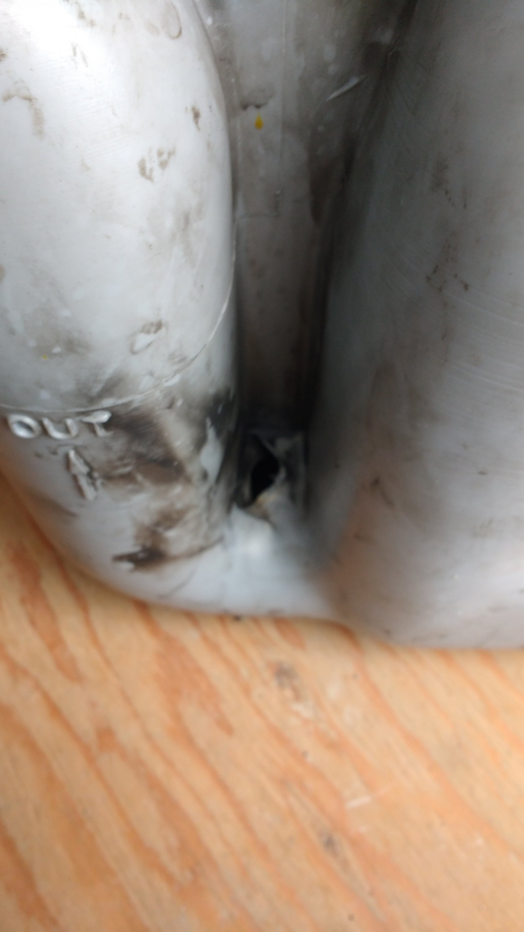

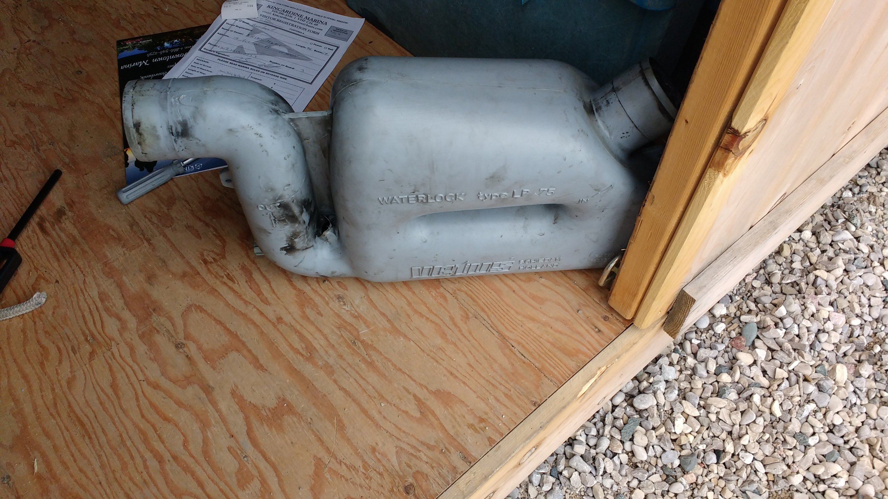

Thanks for all of the advice. Boat is home after a 3 day delivery. One big issue occured just before our second port of call. The water lift muffler developed two holes. Looked like they blew out.
Any ideas what would cause that?
Gunni
Mar 16, 2010
5,937
My guess would be improper winterization. I constantly hear boaters brag about how little AF they run through their raw water system...ignoring that the exhaust system has raw water sitting in it that requires AF.
BH1
Jul 4, 2017
10
Beneteau 461 Sarnia
You are not the only boater that suggested that. On my CS I run pure RV antifreeze until it comes out pink.
We ended up calling a friend up and he fiberglassed the muffler. Held great and got us home.
