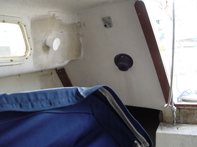

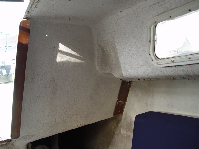

First, what it was painted with. I can guess a brush and must have been many yrs ago it has bad paint lines and that's on the outside. The inside must have been done at a different time with a different paint, I think? It is pealing and I am posting a pic. ot sure how to go about this.

..it looks like more fun than work. For the exterior, I'd tend to try a pressure wash first and then go from there. If the rest of it looks OK after, I'd be inclined to scuff it down and brush on a good quality single part enamel after primering. If it does not seem to be OK, I'd use a stripper, being careful to try a small area first.
As to the interior, I hate to say it, but a girlfriend once painted a large part of my mahogany interior with latex indoor bathroom paint as a 'surprise' (snarl). I hope that isn't true here, but it has that look. Is there something you can take to a paint store to have it looked at? If it is latex, I think you are up against a strip job.

Unfortunately, unless you know what the existing paint is, stripping it is the safest way to go to prep either the interior or the exterior for a new paint job.
I'd go with a power wash as the first step on the exterior. If you don't like the results, then try a chemical stripper—make sure you get one formulated for use on fiberglass and follow the directions. I'd really recommend avoiding sandblasting, as it can damage the gelcoat and laminate, or using a sander, which is just a nasty, dirty, thankless job.
For the interior, pull everything out and see how bad the paint really is... and then start by washing the interior really well...with trisodium phosphate or some other strong degreasing agent. Use a scotch brite pad and elbow grease while washing and you'll probably get rid of most of the loose stuff and leave yourself with a fairly decent surface. You might be surprised at how decent it looks after a good cleaning. If it isn't up to your standards, chemical stripper on all the painted fiberglass is probably the way to go.

I'm thinking along the same lines ...
The interior looks like it has no liner for either the hull or the roof. I don't think I would do the paint stripping. I'd bet that you could get a good, paintable surface by sanding and then painting with the appropriate primer and a one-part polyurethane paint. The wood also looks to be in prett good shape other than the sloppy paint spatters. You can take a lot of the trim off and re-finish in the comfort of your basement. The wood that you can't remove can be finished in place.

Scott T-Bird That sounds like a plan, Everything is nice and hard, Some sanding and a paint scraper may work just fine then. Maybe a little cleaner and safer then stripping, Brian W I would love to avoid chem stripping.
Ross, I'll use some alcohol, may help determine the paint. It is flaking off very easily in a lot of areas.
