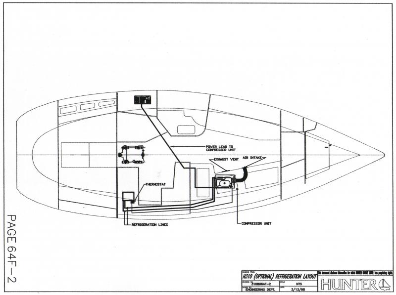

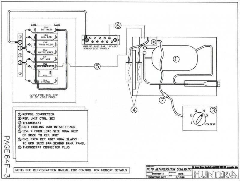

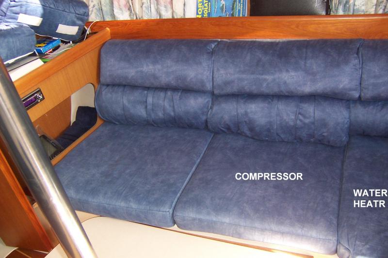

Don't know what success you've had with your previous post on the reefer compressor placement, but our 1999 H-310 came from the factory with the compressor installed in the strbrd centre storage compartment as shown below. Probably the least intrusive location to install.
