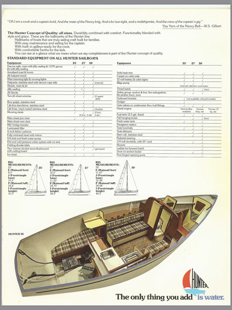

Hey DJ, @dLj the original hot water heater is viewable on starboard side, behind the galley sink, through the lazerette. Ours was replaced by a more efficient model by the previous owner (P.O.) and is located in the same location. I’ve attached a brochure that provides quite a bit of information with respect to specifications and floor plan for our boats.

The cold water line from the tank goes aft to a "T" somewhere near the tank that branches off as a cold water line to the head sink. The other branch goes aft to another "T" in or near the engine space. That branches to a hose to the water heater and to a hose to the cold side of the galley sink. The hot water feed from the heater goes to a"Tee" that splits to hoses that feed the galley and head sinks.
You should consider replacing ALL of the Hoses and Clamps in your system as they are probably original, as you suspect.
