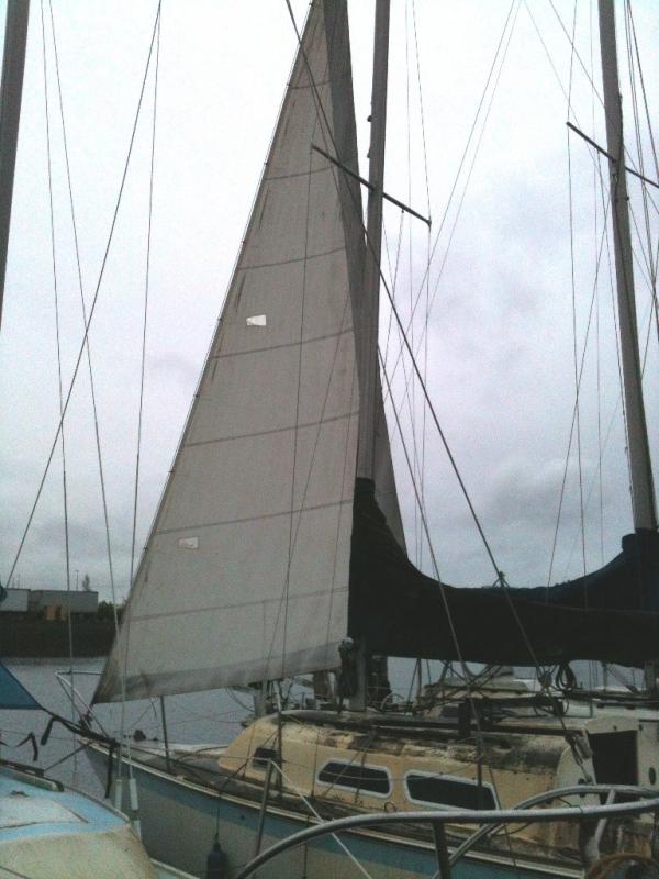

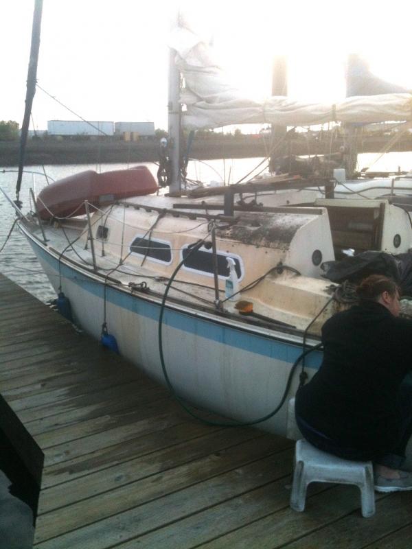

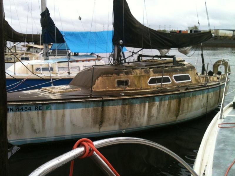

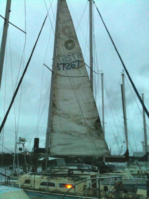

Whoa...that's a dirty sail...but a good soaking should freshen it right up...
And the last pic does show a clean"er" boat than the first...

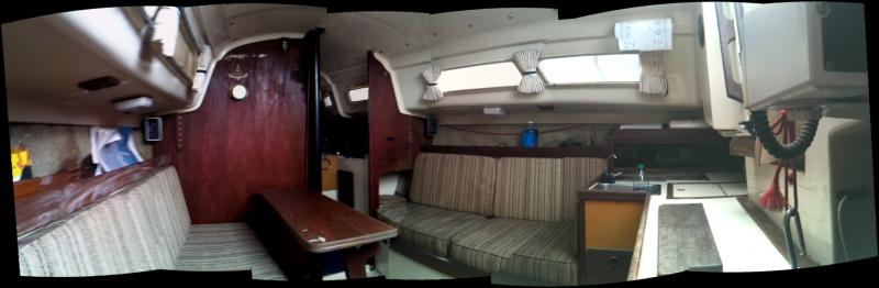

Inside looks nice compared to OS...and the motor runs...
You may have found the proverbial diamond in the ruff...good on ya...

If it seems impossible to get the dirt off the gelcoat why don't you do what I do, get a sponge and Comet then scrub it off, it works great for me and is quick. It does leave a dull finish but I go over it with my vari speed sander with a foam pad on it using "Gelgloss" from Home Depot. Comes up really nice and shinny.

Based on the pic of your rudder, I think you could tape off the bottom paint with plastic sheeting, and hit the topsides well with On and Off cleaner. It should take the brown scum stains off, and might help with the black stuff too. You'll want to consider a hazmat suit and tape on PVC gloves, wear goggles, because On and Off is acid. I hear one shouldn't bother with the On and Off gel, it doesn't work as well as the original.
