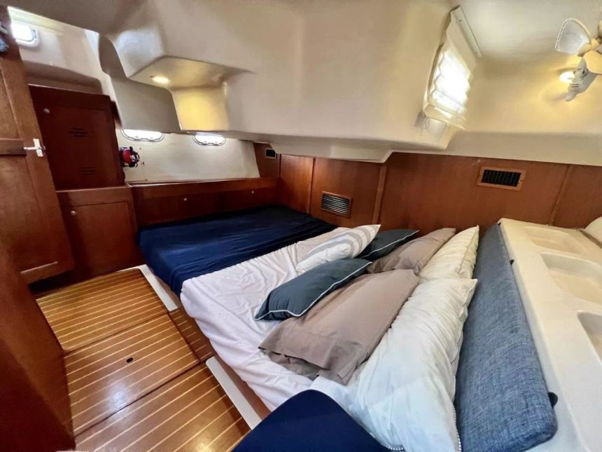

In the second image attached you can see the vent in the aft cabin that the AC is behind. The controls for this AC are on the back side of the standing closet in that cabin. In the image attached it would be about where you can see the red fire extinguisher mounted on its side.
