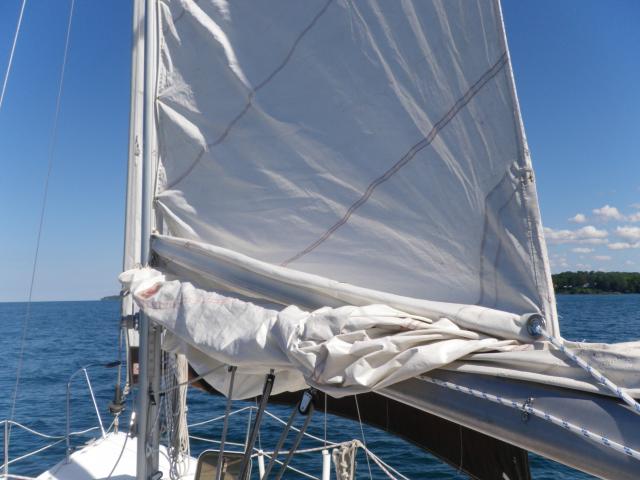

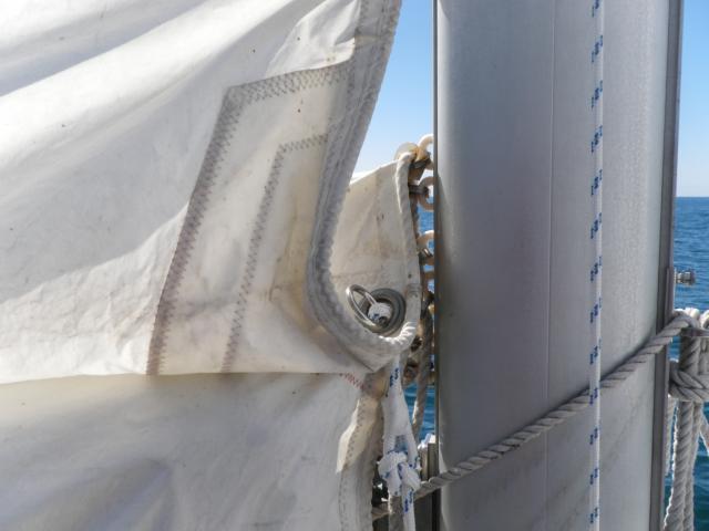

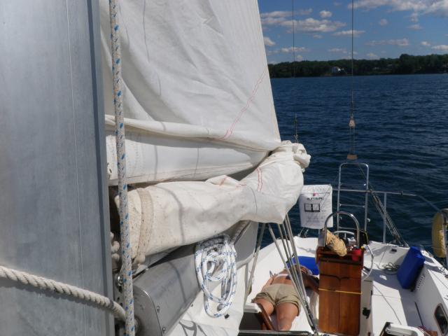

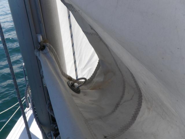

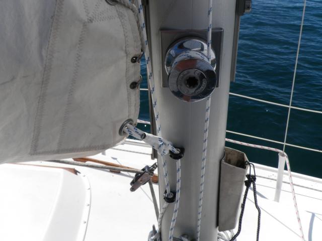

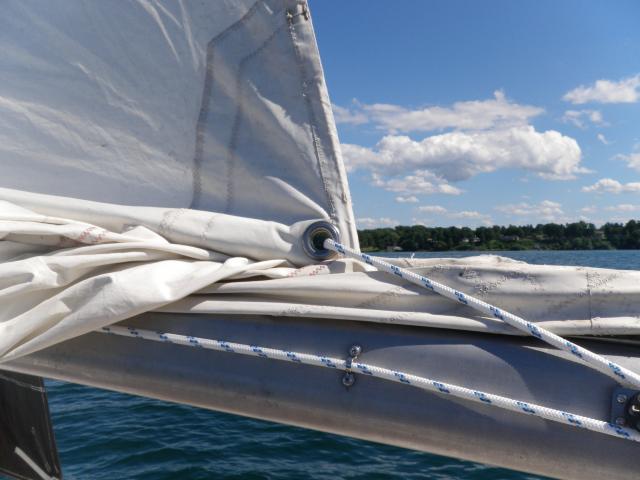

I have some questions about setting up a main sail reefing system on a 77' Catalina 30.
The main sail has 2 reef points with full battens. The PO has set up the pulleys and fairleads on the aft end of the boom for reefing, but nothing on the mast.
My old Catalina 22 was rigged for single line slabbed reefing running aft and it worked great.
I would like to set up the 30 with a double line reefing system. 2 lines at the mast for both reef points on the luff that run down the mast and 2 lines on the clew that run down to pulleys on the boom that lead foward towards the mast. I will have to go forward to reef, but that's ok.
I know that a typical Luff setup would be for a reefing line to be fastened to a fairlead on the port side of the mast and run up through the reefing grommet and then back down through another fairlead on the starboard side to a cleat. Pulling on the line brings the sail down to the boom.
I thought about attaching the reefing line to an oversized ring and passing the line through the reefing grommet down to the fairlead. The ring would prevent the line from passing through and would pull the sail down.
Would this work or put undo or unknown stress on the sail?

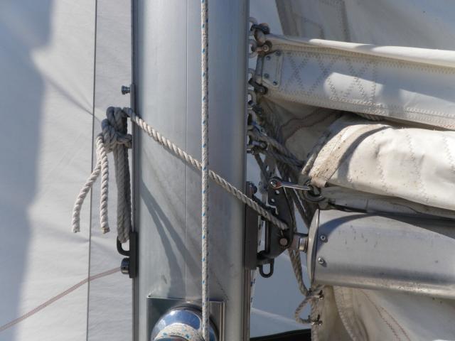

Also, the gooseneck on my boat is not fixed. It floats (as it should) and is currently held up by a rope line that wraps around the mast and is tied to what looks like a spinnaker ring on the front of the mast. Is there a better way to keep the boom up? I do not have a boom vang.
I have read about cunningham rings to help with reefing, but I do not see how they would work with my boom.
In addition, with my reefing system, when I pull the reefing line completely down, it does not draw the reef point on the luff side all the way down to the boom. All of the main sail slugs 'bunch' up in the mast so there is about an 8-12" gap. The result is that if I try to reef even the first reefing point, the clew of the sail is snug down to the boom, but the luff side is high. Is this normal? (one of the pictures shows the 'downward' sliope of the sail while reefed)
I have included a bunch of pictures. Any suggestions would be great.
Thanks
Chris
