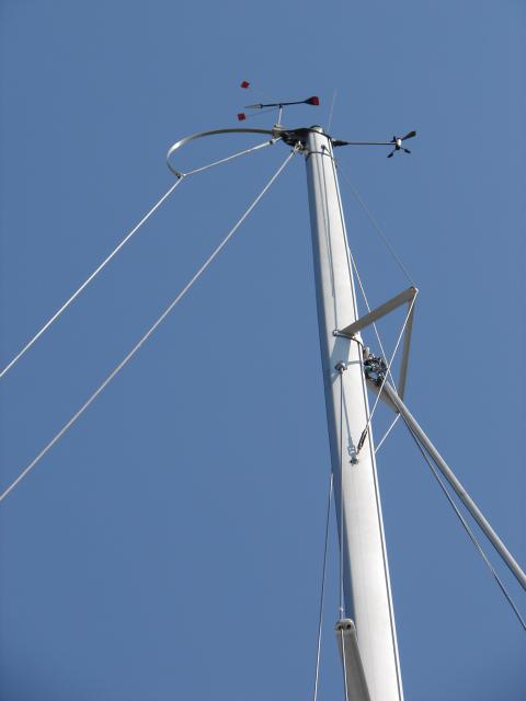

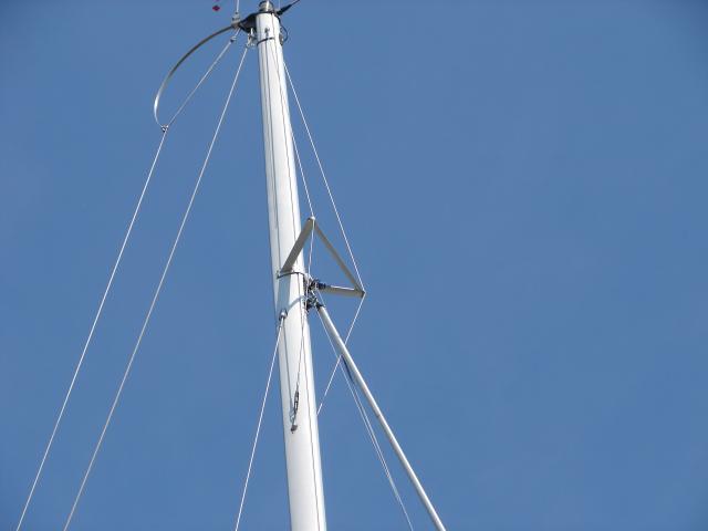

I have located a source for jumper struts for the fractionally rigged Hunters. I was looking for a set for my Hunter 35.5, but they would be very advantageous for anyone with a fractional rig.
Jumpers prevent the headstay from sagging, which is a common problem with this type of rig, and hurts your ability to point.

Holy Cow!! It's hard to believe that not one skipper is interested in improving his boats performance. The addition of a jumper strut is like getting an energy booster.
The ability to control headstay sag is vital to better windward performance. Fractional boats cannot do this without running backstays or a jumper strut.
