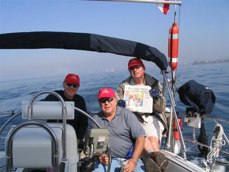

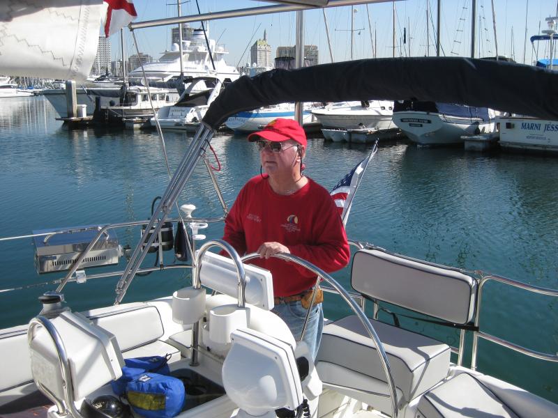

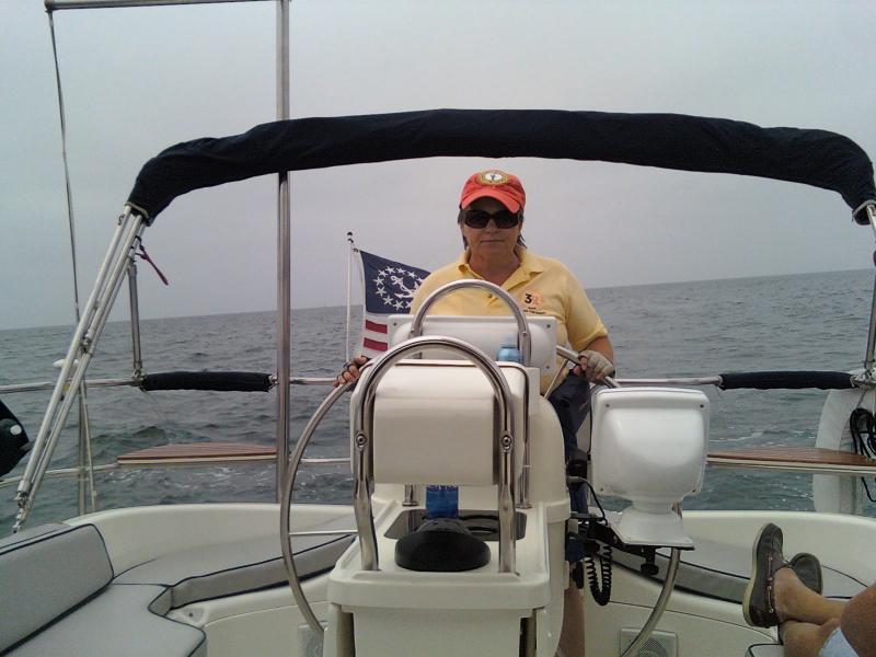

Since your is the LCD, it should not be a problem to mount outside, but I would recommend in a pod, and with a canvas cover. You could even get fancy and make the cover with a isinglass front so you could view the radar if it was raining.
What I did is to mount mine on a swing-away mount so that I could see it from the side if someone else was on the helm or if the boat was on AP and I was not sitting at her helm. Later, I modified the mount and got a pod off e-bay that would fit my unit flush-mounted. BTW, I used it below for a lot of years and you do adjust. It worked fine below on two boats. It's not like you need it every second. The mount and head are on the port side of the steering counsel. There is one picture without the pod and two with.
