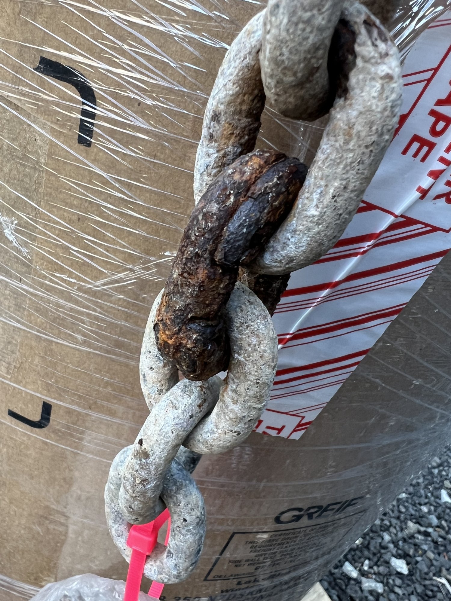

I’ve used them for many years but change them annually. The galvanizing is especially subject to scars during installation.
The link shown in my picture is after one full year of heavy year-round use. I replaced the entire chain (other sections were also worn) so now I’m not using any joiners.

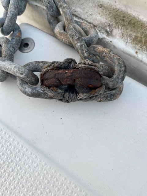

Our seem to last a bit longer than yours. Here it is after a bit more than 2yrs.

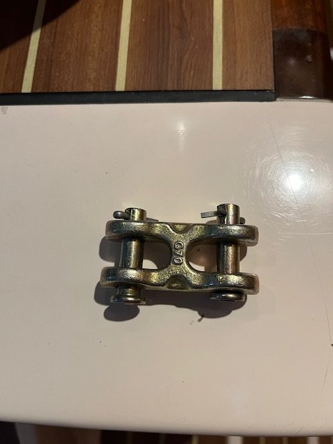

Will probably replace it soon, and I just got one of these links to try. They are G70, and you need one a size smaller than the chain to fit the gypsy (5/16" for our 3/8" chain). The G70 brings the smaller link into the chain's rating. I don't know how well it will fit in through the gypsy yet in use, but it seems to fit well when the narrow side is in the gypsy groove, but sits high when the wide side is in the groove. The wide side would also fit if they had drilled the cotter pin holes a bit closer to the link and made the pins that much shorter - it is the pins that don't fit well because they are too long. You can see the extra length in the pic. My plan is to just watch as that link comes to the gypsy and manually lift it over or twist it edge-way if needed.

BTW, the rust that shows is much less than it looks, and the link is in better shape than it appears. Every time I've cut one of these off, the interior is good metal and after the rust is removed, the dimensions have not changed much from original.
