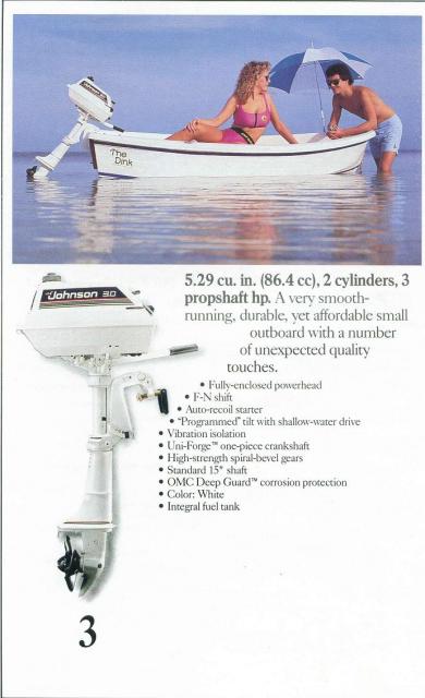

I am basically familiar with that outboard (not as much as my 2001 4hp, but have looked at one and have the 1990 brochure) and as far as I know... Johnson did not put a "telltale" outlet on that motor. If there is water spraying out of the exhaust-relief holes just below the lower pivot (and assuming those holes are above the water level?) then it is pretty sure that water is being pumped through the powerhead by the impeller. On my 4hp Johnson the telltale is located on the lower side of the powerhead and is basically a flow of water that spills out of 2 holes, no real pressure........ and not a lot of volume.
