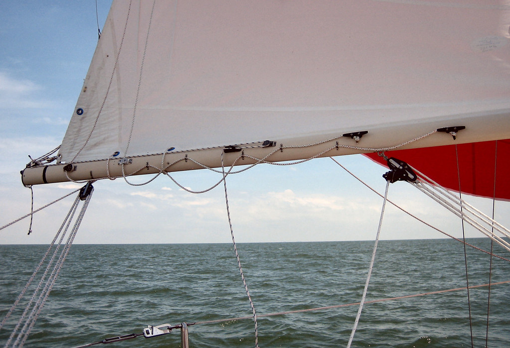

That's a great guide on jiffy reefing Dave. I like the way the sliding cheek blocks are set up on a track for more than one set of reefing points too. All you need for reefing a Mainsail on any boat is a rams horn on the goose neck and a reefing set up like this one and you're right in business. If I didn't have the internal control lines in my boom, I would opt for a set up such as this with the jam cleats near the goose neck on the Port side of my boom within easy reach. Also, the track is long enough for you to select the pulling angle of each sliding cheek block. This alone, takes all the guess work out of it.
