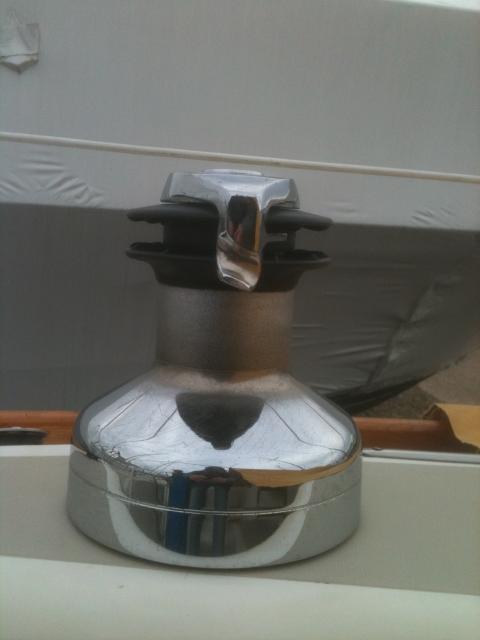

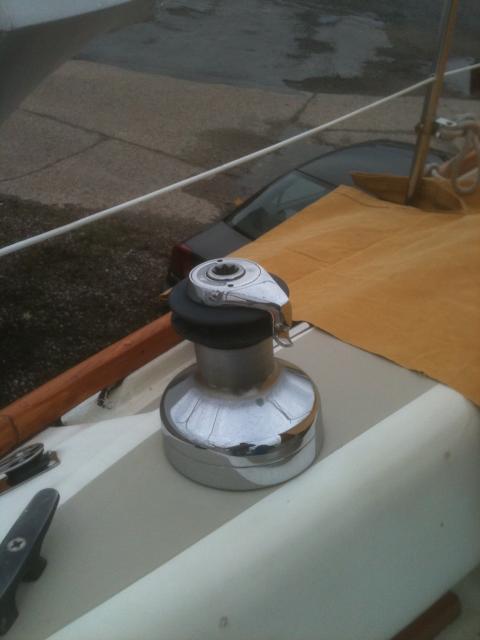

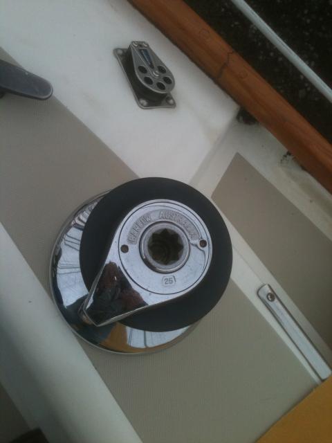

Thanks. Here are a few pictures of the winches. I'm not sure what thickness they need for the self tailors. It sounds like the length should be about 100 feet. I would like to go with something around 1/2 if it is strong enough and will not slip in the self tailors.

Those are the same winches that I have. Half inch works just fine. Speaking of winches, have you ever stripped them down and re-greased them? I did mine last year, it was kind of a nice project and I couldn't believe how much better they worked afterward.

We used a single sheet tied at the center on our Oday 34. Since we only had one jib that never caused a problem. The diameter of the line used in the winches can be changed to some extent by changing the location/arrangement of the shims in the upper part of the Barlow winches. That change can be made when servicing the winches as recommended in another post. The choice of diameter can be more a matter of comfort on your hands and personal choice.
