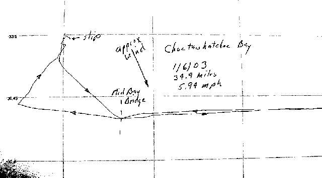

My 79 H33 with jib sheet block on rail does just fine as compared with other cruising boats I sail with. Still, with the sheet block on the rail, the slot is pretty wide and often wish that I could close the slot some more when close hauled. (See track which is about as good as it will do.) As an alternative to tracks which I really don't want to install since the boat really does great except when close hauled, has anyone worked out a rigging scheme using snatch block and line that can bring the sheet inboard and reduce the sheeting angle?
