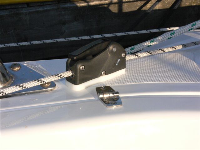

I repositioned the rope clutch:
Moved the block to the stantion base at the rear of the cockpit. This is a much more rugged attachment point. Please note in the photos that the block I am using is small, and ended up with a much larger block of approximately twice the diameter. However from this photo you will get the general ideal.
First, you need to re-position the rope clutch. This took a lot of fiddling. The reaon being that I wanted a perfect run to the starboard cabin top winch. To do this, I made a small base pad out of starboard.
You then position the base so that the line exactly leads to the forward winch.

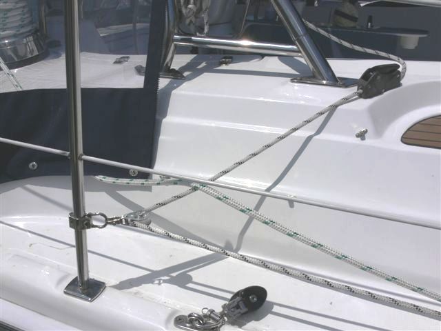

In contrast to what you see now, this was the original Hunter arrangement. You can see how there is significant side stress on the stantion, and the line rubs the coaming. Plus, it is very awkward to lead to the cabin top winch

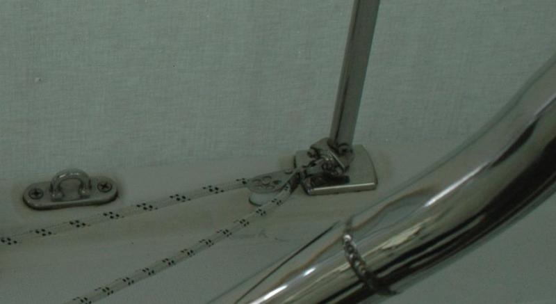

Here is how to mount the aft turning block. As mentioned, I went way up in size on this.

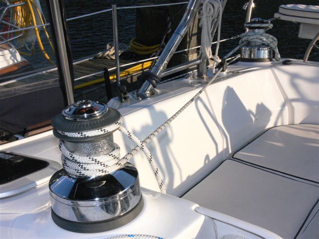

Actually, the way I routed the furling line aft, you can now use the primary for the furling line as well.
Here's where this doesn't work though.
On my boat I have the large #1 genoa. If it is sheeted in on the starboard side, you need to keep the sheet snubbed on the winch while you furl in.
It is actually very easy from the starboard cabin top winch position to furl.
Take line out of self tail, and go down to 2 wraps.
Load Furling line into Starboards cabin top winch self tail.
Now, just ease sheet with your right hand as you push winch button with left.
Boat of course should be head to wind.

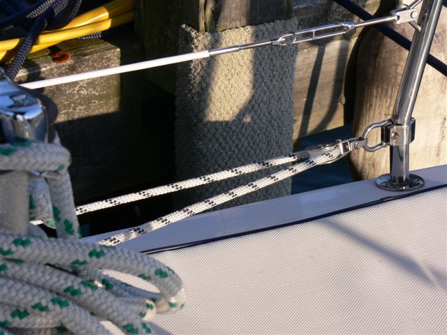

Interesting post and I totally agree with moving the rope clutch. On my 49 the block setup is different than yours. It's lower on the stantion which causes even more ware on the gelcoat by the clutch but probably less pressure on the stantion do to its lower mounting.

You're right.. That is worse

Dave,
You won't believe how easy it is to furl the genoa once you move the sheet stopper, and put the block aft as shown. Be sure to use a reasonably large good quality block. The line is rerouting about 150 degrees, so it has to be low friction with a good quality ball bearing block. (not the one which is currently used in your photo)
