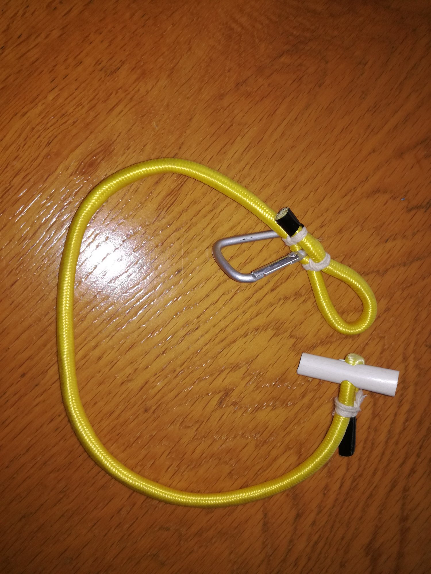

4 I use belaying lines and tidy up line which are 1/4 bungee cord with a loop sewn in one end and a toggle in the other. They can be whipped onto the life line. Cheap, fast and easy.
