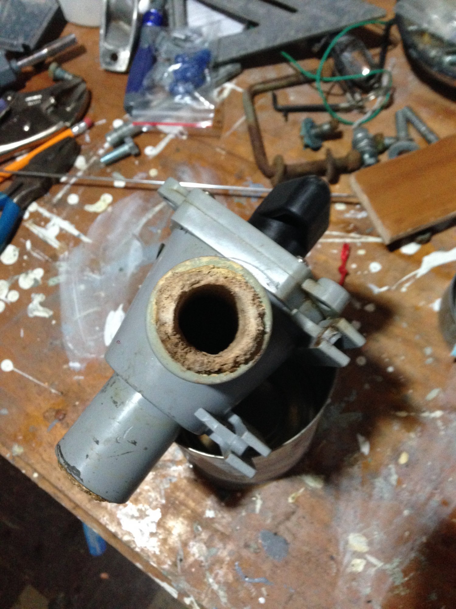

The hoses smell which tell me they are old. You're pumping overboard, so you are in salt water. If this is a manual pump or even if it is a macerator, I suspect the hoses are clogged with calcium and the ID is not longer 1.5" and is actually much smaller. When it is time to pump overboard, the hose quickly clogs with TP or whatever is in the tank. The solution is to replace the hoses and clean the valves and rebuild or replace the pump.
To give you an idea of how clogged the hose can get, here's a photo of my Y-Valve before I cleaned it.
