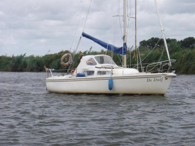

Saw a few Jaguar 22s in England and The Netherlands over the years. They also produced a Jaguar 25. We've had both, but they call them something else over here...
