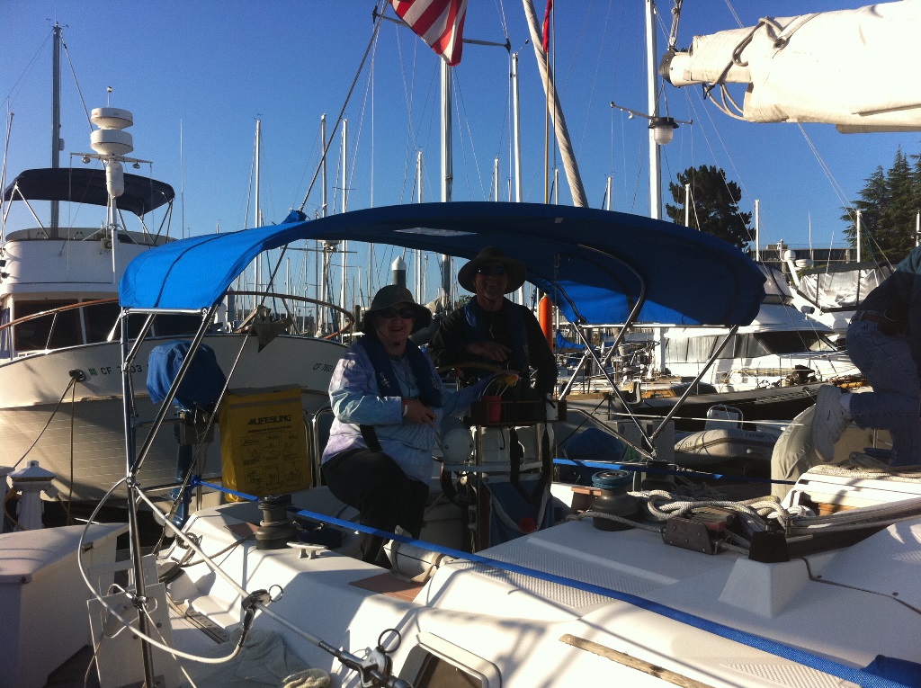

Joe shared some really good videos. I dug around but could not find a picture of how I secure my jackline to the bow. As I said earlier, mine has a sewn in loop and a spring loaded carabiner. I take one wrap under the horns of the bow cleat and clip the carabiner to the webbing. Then I take the webbing and do two figure of eight wraps on the cleat as if I were tying off a dock line. Then it goes aft, inside the rigging. I now cleat the aft end in front of the primary winch, pulling the webbing very tight and putting three overlapping figure of eight wraps on the cleat followed by two half hitches. I don't want that end to slip.
The only picture I could find is when I used to tie the webbing off at the stern rail. There I tied a several criss cross tucks on the railing followed by two half hitches. That could still work but I like the addition in Joe's second video of the stopper line so you can't fall over the stern.
