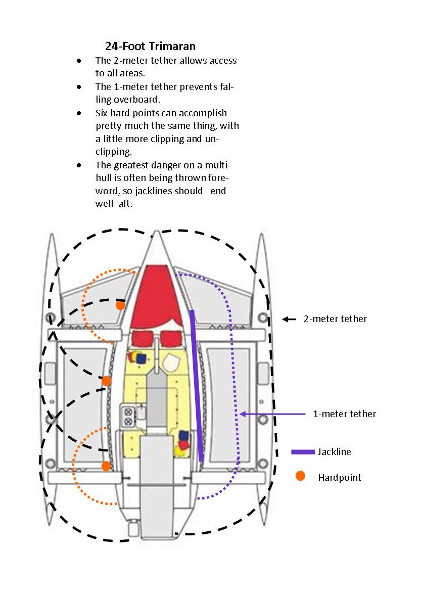

Maybe this will give an idea, showing 3' and 6' tethers and a few possibilities. As you can see, 3' tethers are more useful and the jackline does NOT need to run to the stern or bow on a small boat.
As you can see, on my F-24 the jacklines end far short of the bow and stern.
