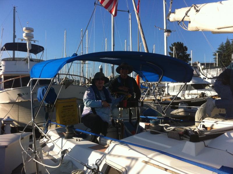

YVRguy,
Took a while but I found a photo showing our safety lines just prior to an ocean trip. We use the webbing purchased from West Marine that has a snap shackle on one end only (6000 lbs breaking strength). That end is wrapped around the bow cleat and clipped to itself. The rest is run back on the inside of the rigging (under the jibsheets) and tied very tight to the aft rail. It allows clipping on as soon as we come back into the cockpit. Sometimes instead of tying off at the stern rail I secure them to the cleat in front of the winch on the coaming. That makes it easier to step over when getting on and off the boat.
When done I always wash the webbing in a bucket of fresh water to get the salt out (salt crystals are very abrasive) and hoist them up the mast to dry. Then I roll them up and keep them in a Ziploc bag.
