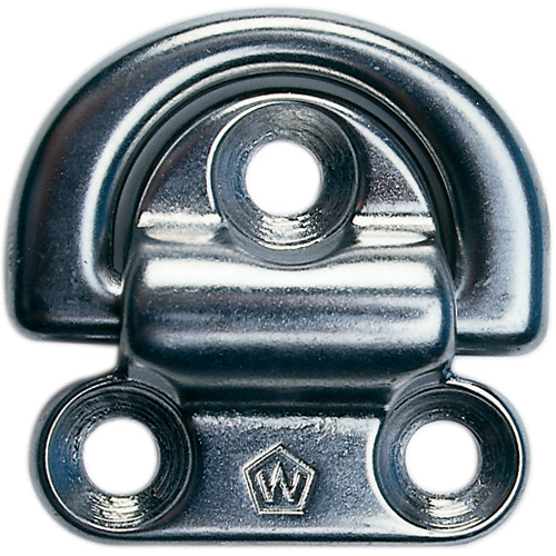

Yes on the pad eyes.
I favor the wichard. It folds flat when not in use. Strong design. Available with a backing plate.
