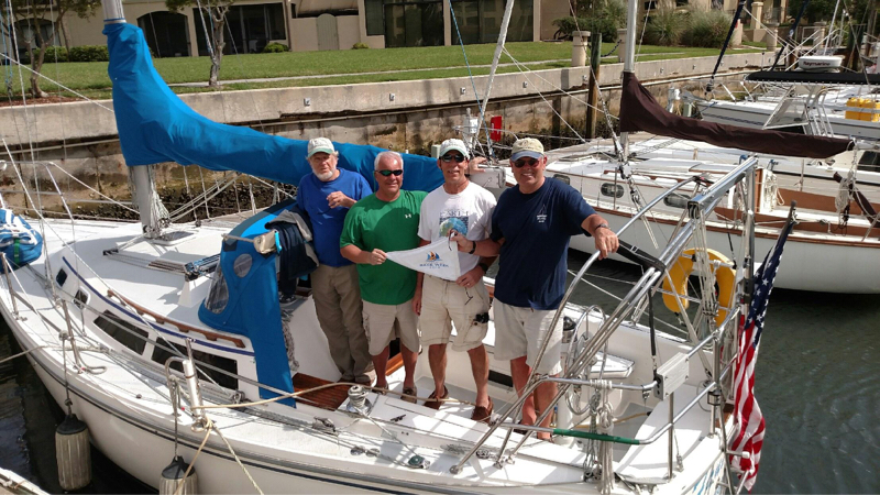

From stern cleat to bow cleat. Jack line is the grey webbing in the picture.
