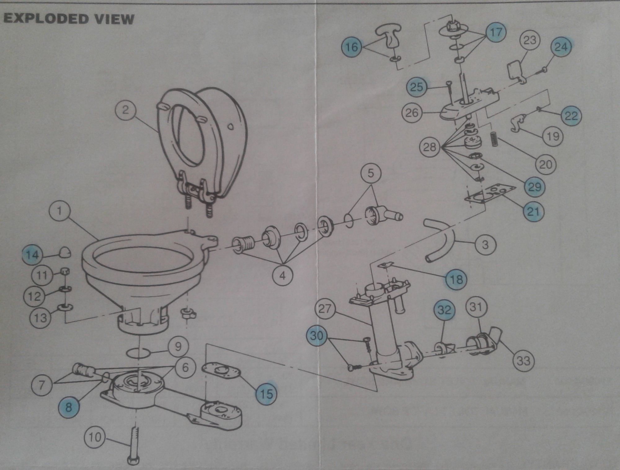

Newly acquired 2000 vintage boat with original Jabsco head. Trailing her home, with the valve on "dry bowl" setting, I got seepage of unpleasant fluid back into the bowl. The holding tank only had a little in it. In the exploded diagram below, number 32 is described as a "joker valve", although I think that should be choker valve. Is this the culprit?

It really is called the joker valve, and yes those symptoms sounds exactly like that’s the problem.

The backflow is NOT coming from the holding tank. The inlet fitting on a holding tank is at or on the top of the tank...you've said there's very little in the tank, which means tank contents would have to jump up to the inlet fitting to run back to toilet unless the tank is lying on it's side. So what IS running back is waste that never made it into the tank, is left sitting in the toilet discharge hose.
The wet/dry mode has nothing to do with OUTbound waste in the bowl...the WET mode, allows the pump to pull flush water IN, the DRY mode blocks incoming flush water.
A brand new joker valve (yes, that IS what it's called...I don't know why either) will prevent back flow, but only till enough flushes have gone through it to stretch the slit in it. At first it's slow seepage, but the more flushes that go through it, the wider the slit gets...until it finally becomes a hole. If it's never been replaced, it might as well not even be there.
If your toilet is original on a 10 year old boat, it's 10 years old...the average life of a Jabsco manual toilet pump is 2-5 years, so I suspect the pump has been replaced at least once. A replacement pump is inexpensive (forget installing a "service kit"...it's a PITA to do and the price is 85-90% of the price a new pump) and replacing it is easy--remove the 4 bolts that hold it on the base, remove the inlet and discharge hose...bolt the new pump the base, replace the hoses...and it's done. There will be a new joker valve in the new pump...it should be replaced annually--or at least every two years.

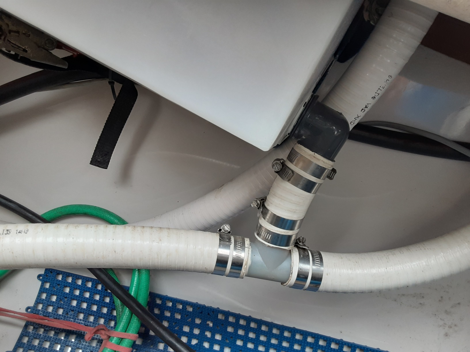

Thank you Apex. The first owner changed the holding tank system ti a "KISS Type III MSD" system, as described here:
All lines, including vent, are about 1-1/2" ID to judge from their external appearance. The holding tank is high in the starboard lazarette, occupying otherwise underutilized space.

We have a similar problem, just bought a 2016 Jeanneau with a Jabsco manual head. The bowl was filling up with waste water which I believe is from the hose that goes to the top of the tank. Yesterday I replaced the entire pump assembly with a new pump assembly, which included a new joker valve. It worked well yesterday, but this morning the bowl was full of waste water again. Am I overlooking something here? I thought the new joker valve and pump assembly would fix it.

If I read you correctly, it's an uphill run from the toilet discharge to the tank inlet. So if you aren't pumping enough times in the DRY mode to push the flush all the way into the tank, what's left in the line will do what water an just about everything else does: run downhill to the toilet. The joker valve only keeps it out of the bowl until it becomes too worn to do so.

Yes, the discharge from the toilet goes vertically about four feet then into the top of the tank at a right angle fitting. Wouldn’t pumping in the dry mode just send air bubbles up through the waste in the 1-1/2” hose, especially if it is mostly liquid waste? Thanks!

I think that is the point, empty the hose as much as possible so the #'s are not sitting in the hoses, but in the tank. Anything left in the hose is being pushed by gravity back to the loo
