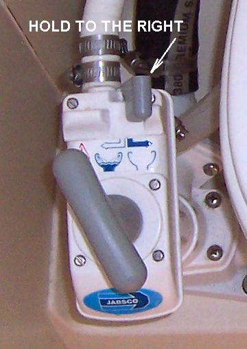

This is quite likely an oversimplification, but I get similar results when the WET/DRY selector is not jammed fully to the right. It often slips. I usually hold the selector switch to the right, by hand, when pumping. The backpressure may actually be vacuum.

Ralph - That might actually help. I know pushing the switch to the DRY mode does 2 things:
1) close off the raw seawater intake flapper on the right of pump. (This would not cause the problem I am seeing)
2) hold open the flapper on the left side of pump that allows air/water to flow from back/top of bowl to Jabsco
The second one is promising since that would cause a vacuum and perhaps this exact symptom.

I could not push the pump handle all the way down with the lever incompletely switched over if I remember correctly; but, that certainly is a simple thing to investigate!

I just got back from the boat.
Ralph was right...holding the switch all the way to the right (DRY mode) solved the problem. I know when you switch to DRY mode, there is a hook which is supposed to open the flapper and the left hand side which allows the tube from Jabsco to rear/back of the bowl to provide air. I assume this flapper was not fully opening until I pushed the switch all the way to the right. Honestly it seems like a bit of a design defect that it is that sensitive. I might contact Jabsco.
I also agree the "vent hypothesis" sounds promising but if that were the problem, I would also get back pressure in WET mode but that was NOT the case.
I've thought the same thing but in the end, I'm still there ................. holding my pants up with one hand, holding the WET/DRY selector hard to starb'rd with the other hand, pumping the plunger with the other hand. Wait, that's three hands. No wonder it's so bloody difficult sometimes.
