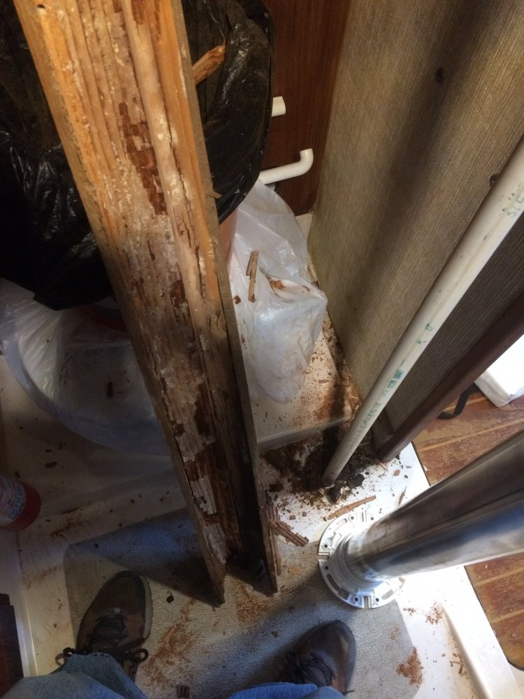

Had the same problem with my Jabsco a couple of years ago so, I replace the whole pump assembly. The new one did the same thing. Happy to hear it's a mfg defect and not a problem with the venting I installed last year (new 1" lines).
I would do the Raritan everything-but-the-bowl replacement, but on my H27 the new compression post I installed would interfere with the Raritan handle.
Bummer!

Actually, after looking at the tech drawing in the link you provided, I see the flush handle doesn't stick out any farther than the front of the bowl. In all the marketing pics it sure looks like a longer lever. Maybe I'll check into it. Hmmmm....
It has a telescoping handle, to keep it out of the way when necessary. You must have missed that in the promo sheet I sent you.
