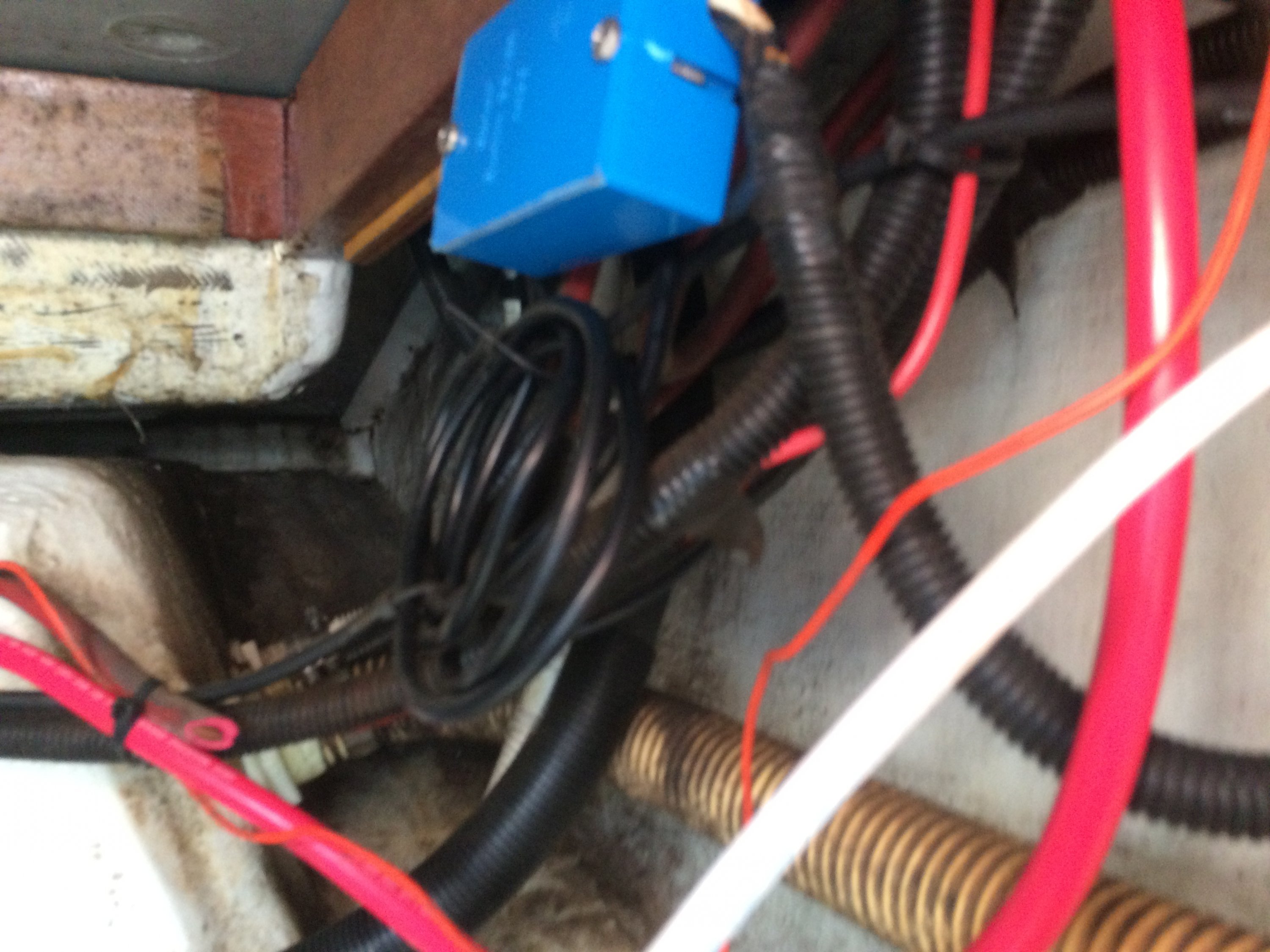

I've just taken possession of a new to me Slickcraft (Shhhh - I know this is a sailing forum but I still do have a sailboat). Among other problems the battery charger isn't working. Through serial #'s etc. I've learned it was manufactured in 2011. It is a Pro Spot 12 whatever. I've spent a lot of time on MS's web site re battery chargers and decided for my use the new Promariner Pro whatever 20 would fit my use, which is charging during the week at my dock. Imagine my delight to find it or something close on sale at West for the 4th. They had 1 in stock and I bought it today. When I got it home I realized the 30' of AC supply I expected turned into about 6' of AC - with a plug. I didn't really want the plug because I assumed I would hard wire it into the dedicated circuit on my AC panel. In looking back at the websites for the chargers I noted that the 12 amp replacement has a plug too! Maybe they all do? I remembered that there is a blue plasitic box that I could barely see and could not ID the use for in a photo when I shoved the iPhone up there. Could this be a junction box and the charger is plugged into it on the invisible side? Or what the heck is that? Dam PO.

I'm guessing it houses a relay.
Open it and look inside. You'll know then.

From your picture, it looks like it could be a plastic junction box. That PO guy sure does get around. Comes up with some really funky ideas. Few are proper Marine Electrical design, but many come from the nearest box store.
Bet he has stock in them box stores.
Let us know what you discover. Keep in mind it is a "POWER" boat. Powered by a power plug...:clap::laugh:

Cut off the plug and add ring terminals and wire it directly to the charger breaker at the panel and the AC neutral and ground busses. I just did this project. My OEM installation was a household AC outlet in my engine compartment. I was putting in a new charger and read that ABYC or some other code prohibits AC plug in connections for battery chargers.

Well then the AB Yacht Club (ABYC) won't be invited on my boat! Seriously, I did put an outlet sorta in the engine compartment. It was that blue junction box shown in my picture. The charger wires wouldn't be long enough to get to the AC panel. The old charger was wired to that same box. I didn't want to cut the plug off since I think that would void my warrantee. So, Bless me ABYC for I have sinned ...." But it was the least sin I could come up with.
