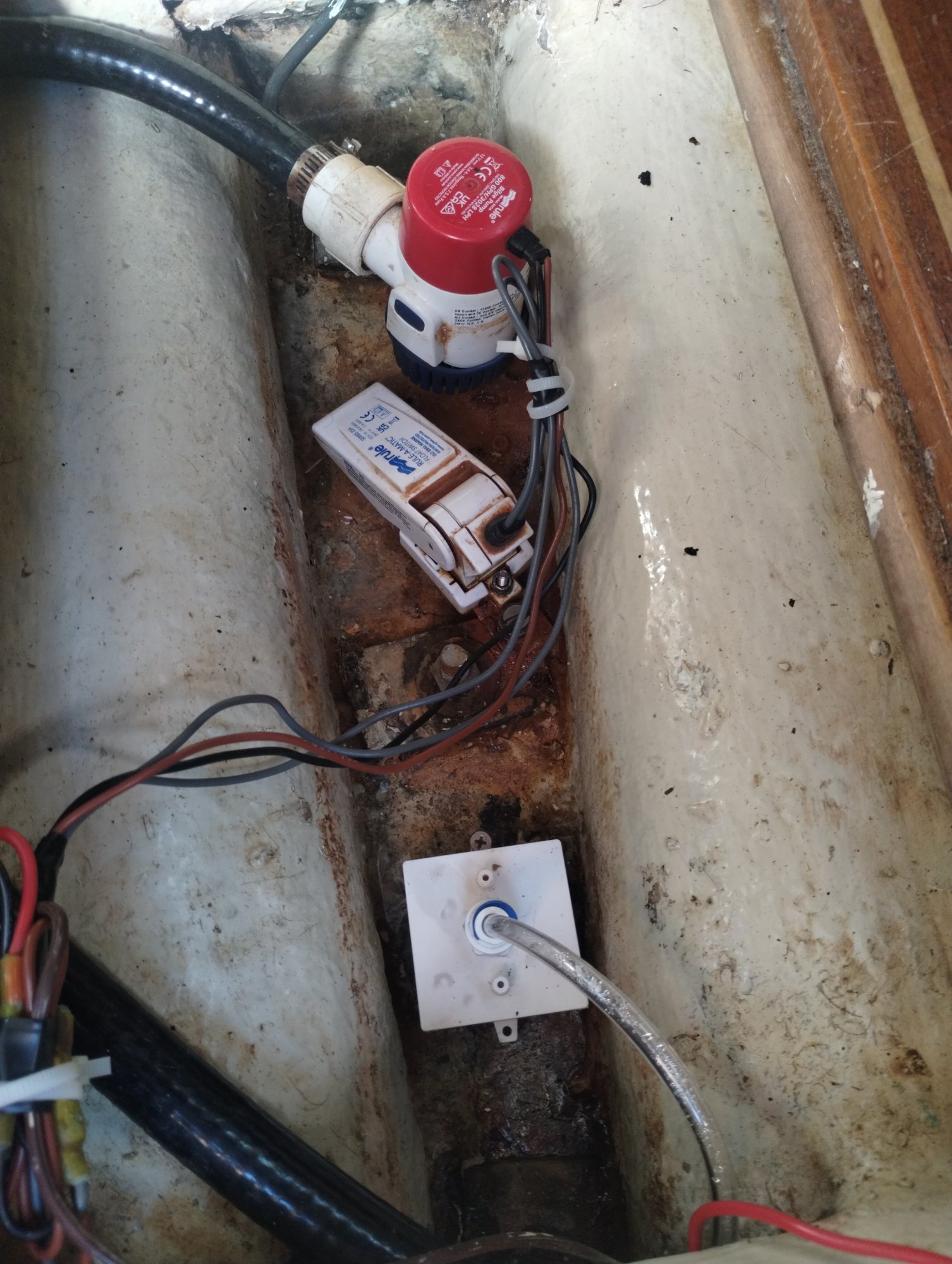

For the last month, I decided to embark on some leak hunting. I was unable to dry out the bilge (it just kept coming from the stringers, slowly) and started to get concerned i had a keel joint leaking.

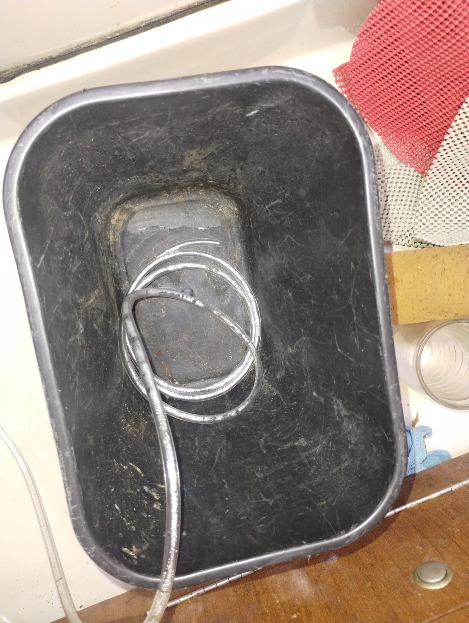

Invested in a seaflo dry bilge pump, which runs 2 minutes, 3xa week, and it's just filling a trash can. I wanted to keep the bilge low, so that the stringers could actually drain, but also track water removed.

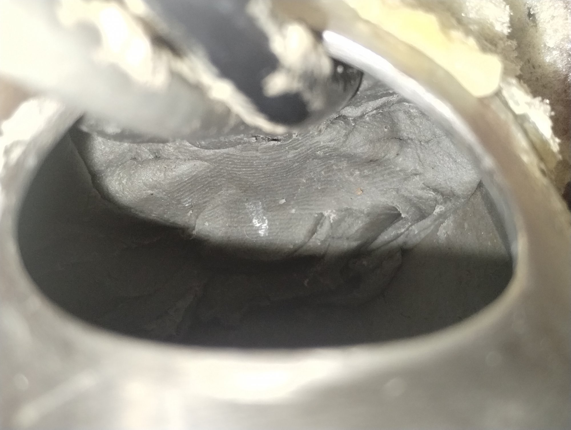

Determined though this process that the wiring penetration in the mast was a major source of water, and actually drilled a 3/16 weep hole in the compression post base (which had at least a quart come out).

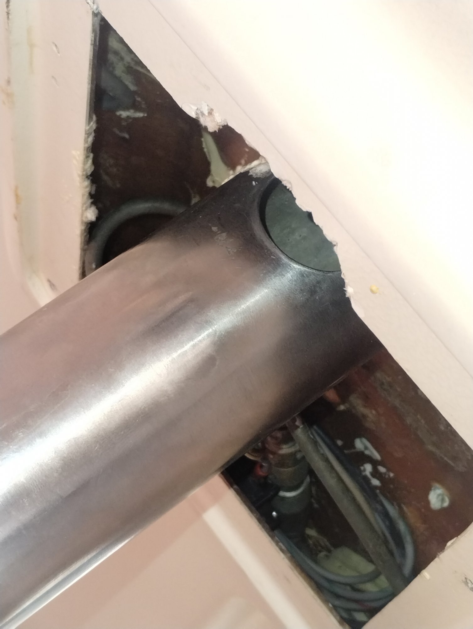

I managed to seal up the penetration, which is about a 1 inch pvc pipe, with HVAC line putty, applied with some special tooling ( an aluminum bottle opener) . It's not easy! The hole is only accessible through a hole in the side of the compression post. Had to remove some of the fiberglass to get access, though this is all behind the (fell apart when removed) cover plate.
Very hard to see, but i got 2/3 of an entire 1lb brick shoved into that tube, taking care to go on both sides and in between the wires. My fingers still hurt.

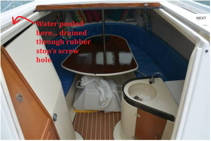

That must feel really good. Mystery leaks are the bain of all sailors. I had an H26 that would get a leak that showed up as brown water running down the hull sides inside of the head compartment. The odd thing was that it only showed up several days after a rain. I removed and rebed all deck hardware above the head compartment.... no joy. I replaced the seal around the port.... no joy... I purchased a companionway cover and some joy...
After a few seasons of trying to figure this out... I discovered it was the rubber stops that show up in the companion way slides. The screws had penetrated the fiberglass.... then any rain that settled in the slide gooves would slowely drain through the screw penetration... It was an easy fix once I knew where to look.
