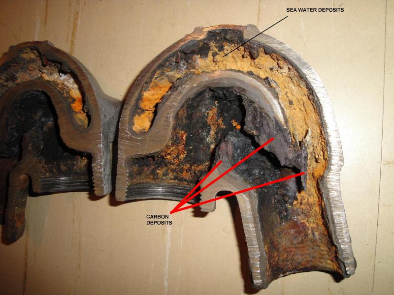

how old is the mixing elbow on the exhaust it sounds like yours is getting clogged up and may need cleaning or replaced

Mixing elbow about four years old no overheating issues

............... ^$%&*\!$ is the easiest item to check and a likely cause of your problems.
Note that the water passage on an elbow can be reasonably clear hence no overheating, but the gas passage can be plugged. The fact that this one worked without causing any engine problems whatsoever is proof of supernatural intervention :eek:.
