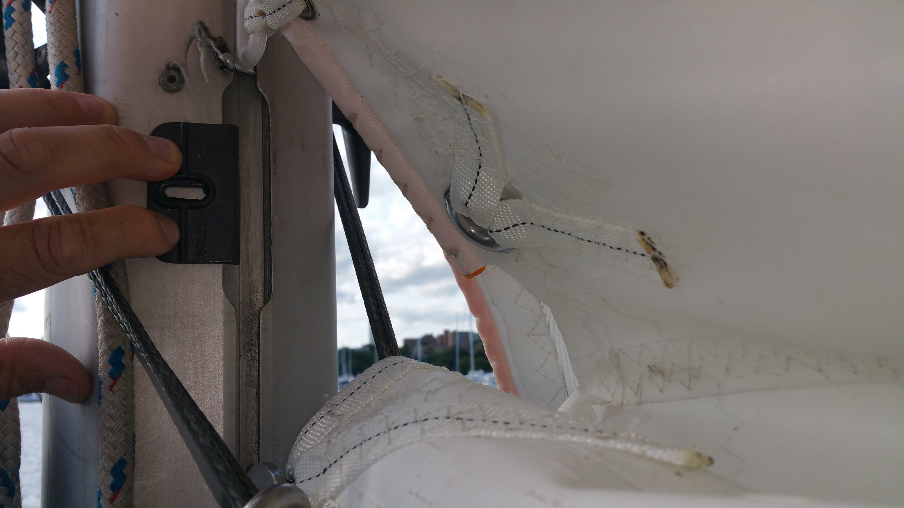

My O'day 34 came with a cotter pin on a string riveted to the mast which is inserted into the sail slide track to keep the sail slides from dropping into the slot. The original main had the bottom several slides installed on a piece of line woven through grommets in the luff so that the reef cringles could be brought down to the reef hooks. My new main does not have the bottom slides on line, but instead has conventionally attached slides. This week I ordered the mainsail gate from RigRite, and went to the boat to install it. When I held it in place, I was surprised that the slides could still pop out of the slot with the gate in place. It seems odd that the slot is open on both sides of the sail track. Perhaps I have an incorrect idea of how the gate is to be installed? Anyone else with an Isomat mast that could comment or send a photo of their setup?

I understand that I need to install the thumbscrew to make my gate functional, so when the gate is pushed toward the center the slides will not be able to pass. When the gate is pushed to the side, the slides can pass (as they need to do in order to reef) however as they pass they can also pop out, because although the gate is covering half the slot, the side away from the gate is still open, so the slides can pivot out of the track. Does anyone with an Isomat mast have a similar arrangement?
