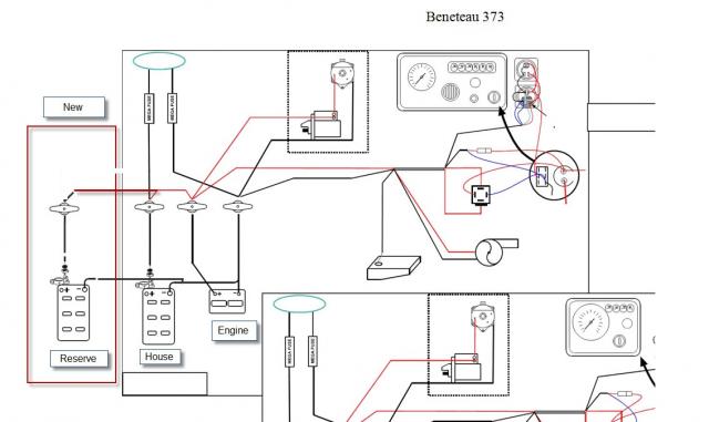

I'm currently working on updating my electrical system to accommodate new Odyssey batteries. I've looked at a number of threads that talk about the challenge of isolating the house and reserve batteries, but none that are specific to the Beneteau set-up. I'm looking for help with the following questions:
1) how to "unparallel" the two red +ve switches
2) ensuring that all loads are off the reserve battery
3) using the Nav station volt meter for only monitoring the reserve (have Victron 600 monitor for the house system)
Thanks in advance for any responses and advice.

Not sure what you mean by reserve battery.
You have your house and engine batterys and the connection between the two (at the switches) allows the charging of either battery with the alternator. If you disconnect that jumper you can't charge the house battery with the alternator.
If you mean you want to add a reserve battery see attached 373 schematic.
Maybe I'm not reading this correctly:confused:

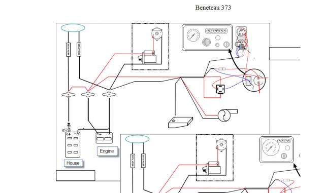

Ok

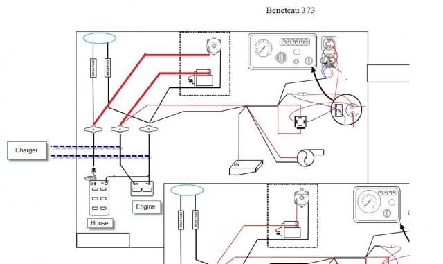

First schematic shows existing system.
Second shows what you want to do.
Remove the jumper, move the alternator wire over to the House battery.
Attach charger to Engine battery.
This removes some of the flexiblity that the exsisting system has.
Also if the motor is running and the house battery is off the alternator will not be generating any power.

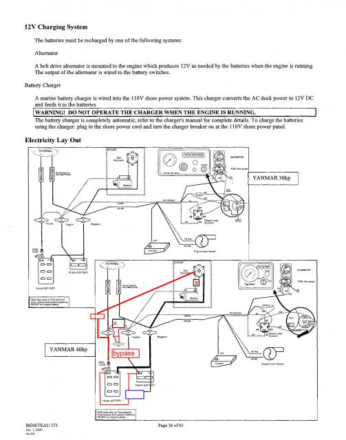

Dworob:
I also have a 373 (2007 #26). Attached is another interpretation of the image attached by Joker 460. It is a rough diagram of my setup modifications when I installed a Xantrex Echo-Charge, along with a new, normally opened, bypass switch and an in line fuse.
I concurrently installed a Balmar ARS-5-H programmable regulator and an Amptech S125Se 125 amp externally controlled alternator. All have worked well.
The blue square is the Echo-Charge. Note the removed tie between the two existing switches and the removed line between the starter and the alternator. I used a standard Beneteau switch for the new tie. The new fuse was a ANL 150A. All new wires were 2/0 battery cable.
