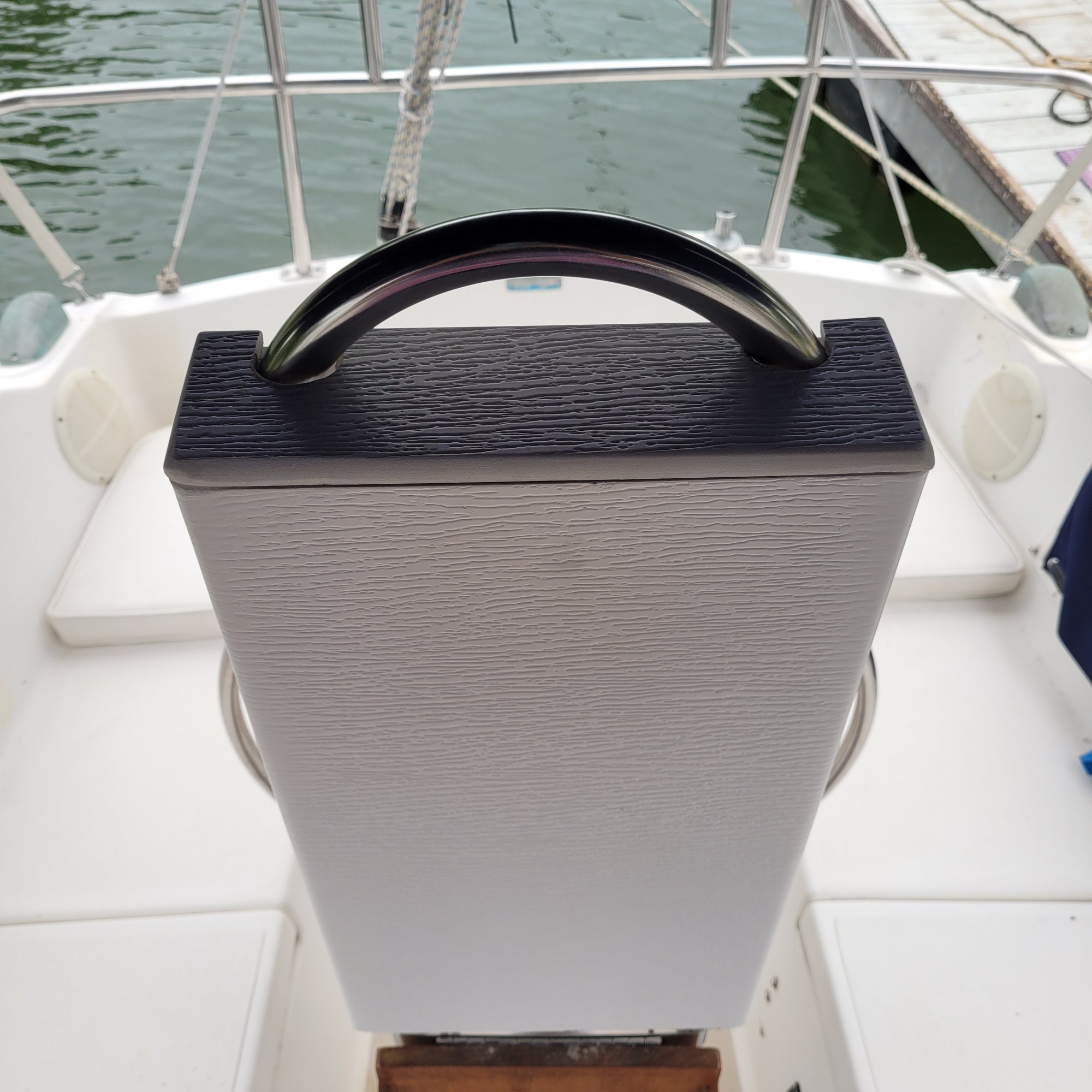

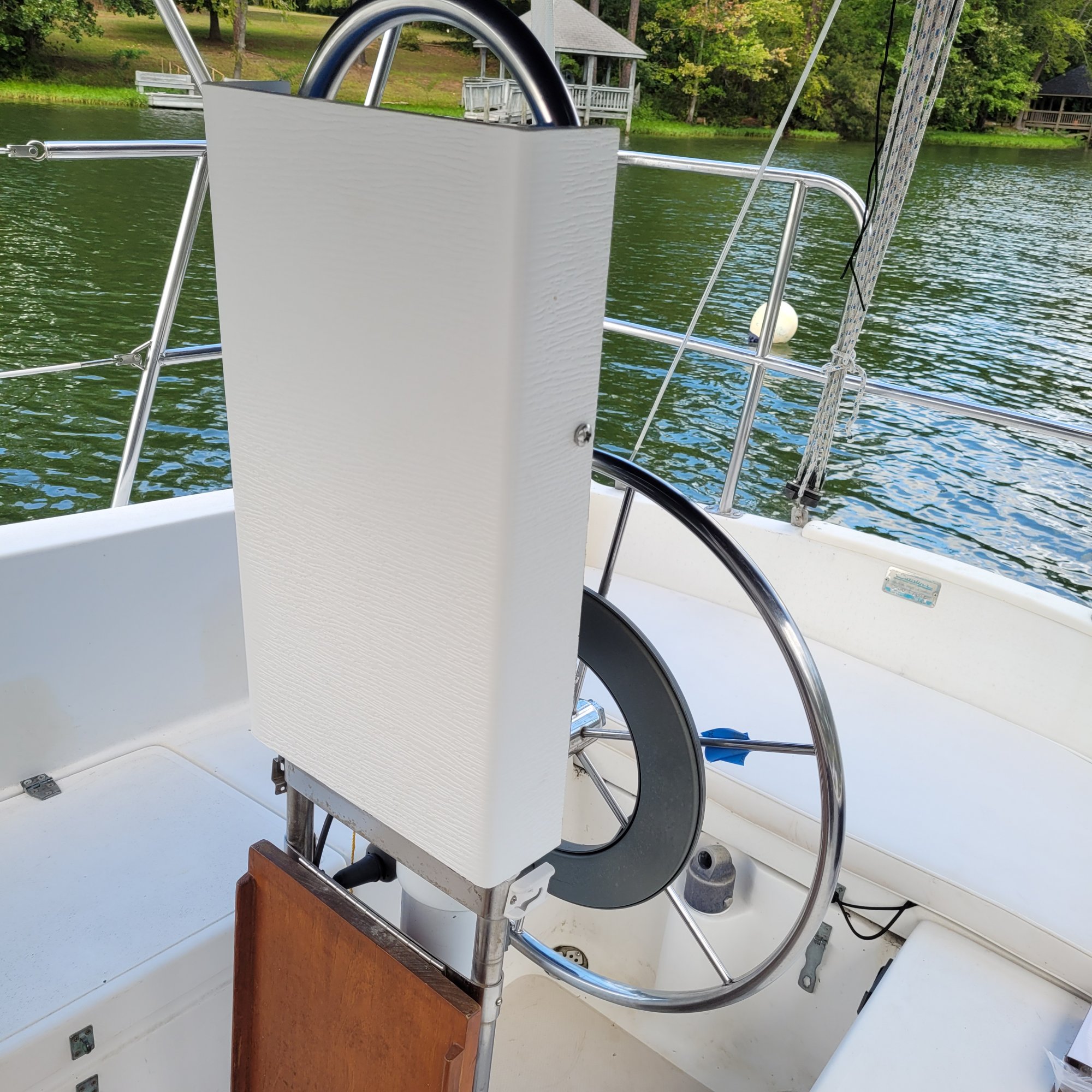

From my other thread, I was greatly bothered by the Mark 1 lack of clearance between the cockpit seating and the large destroyer steering wheel, So I Got a 22" Destroyer wheel from EBAY installed about 6 weeks ago. Was $200 shipped. I can just get my knee past it. I've not had it out in any huge air yet, but so far I like it quite well.
No More walking on the cushions!

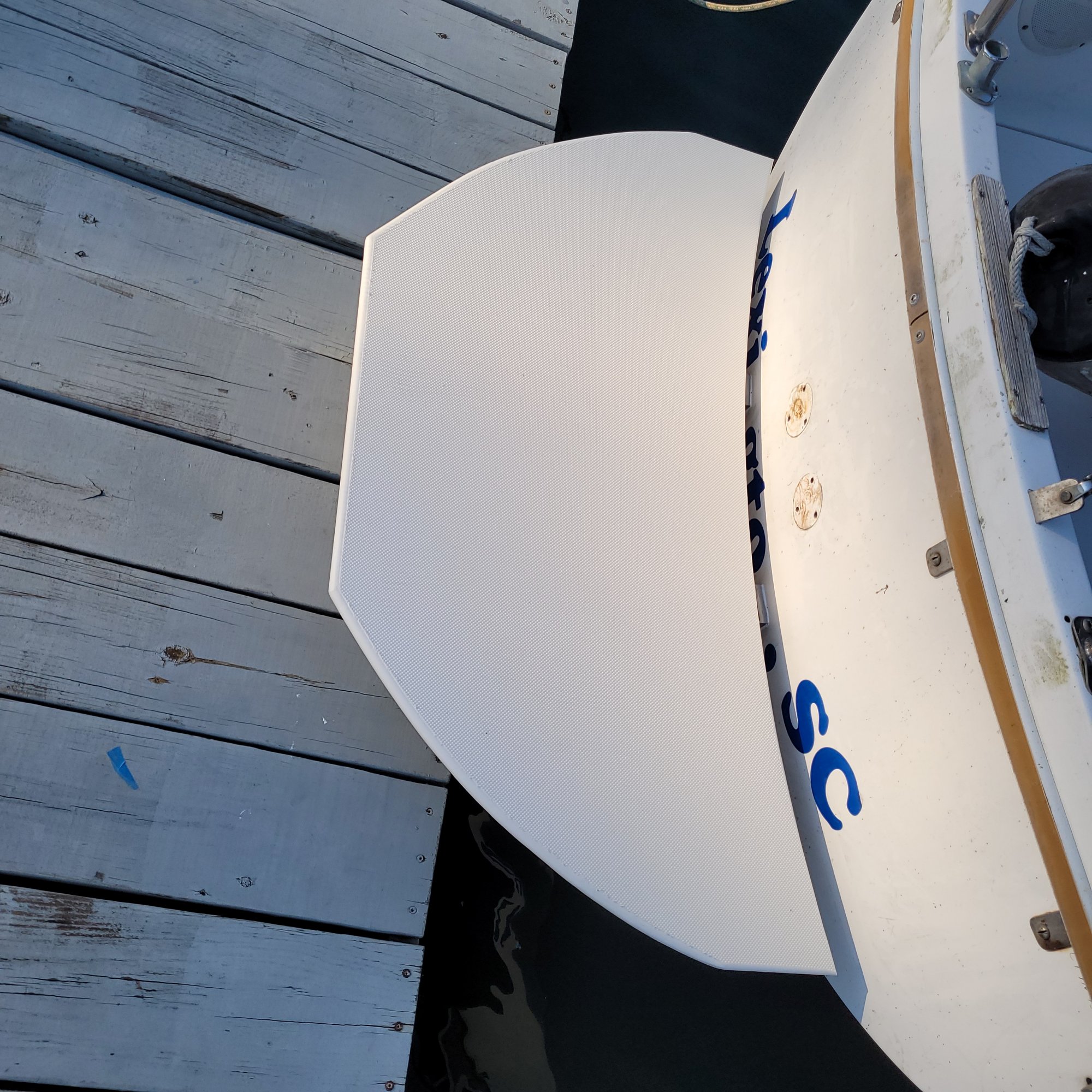

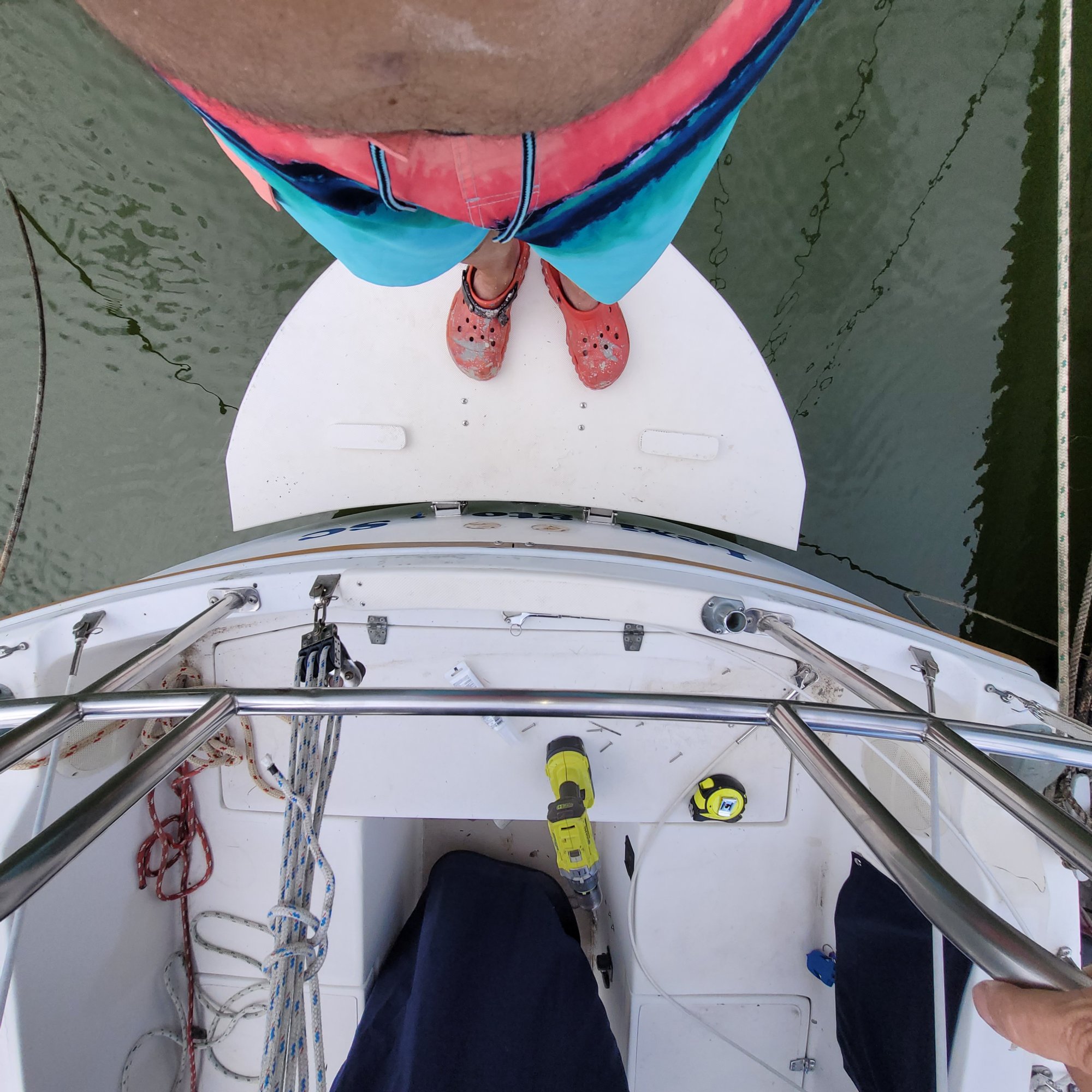

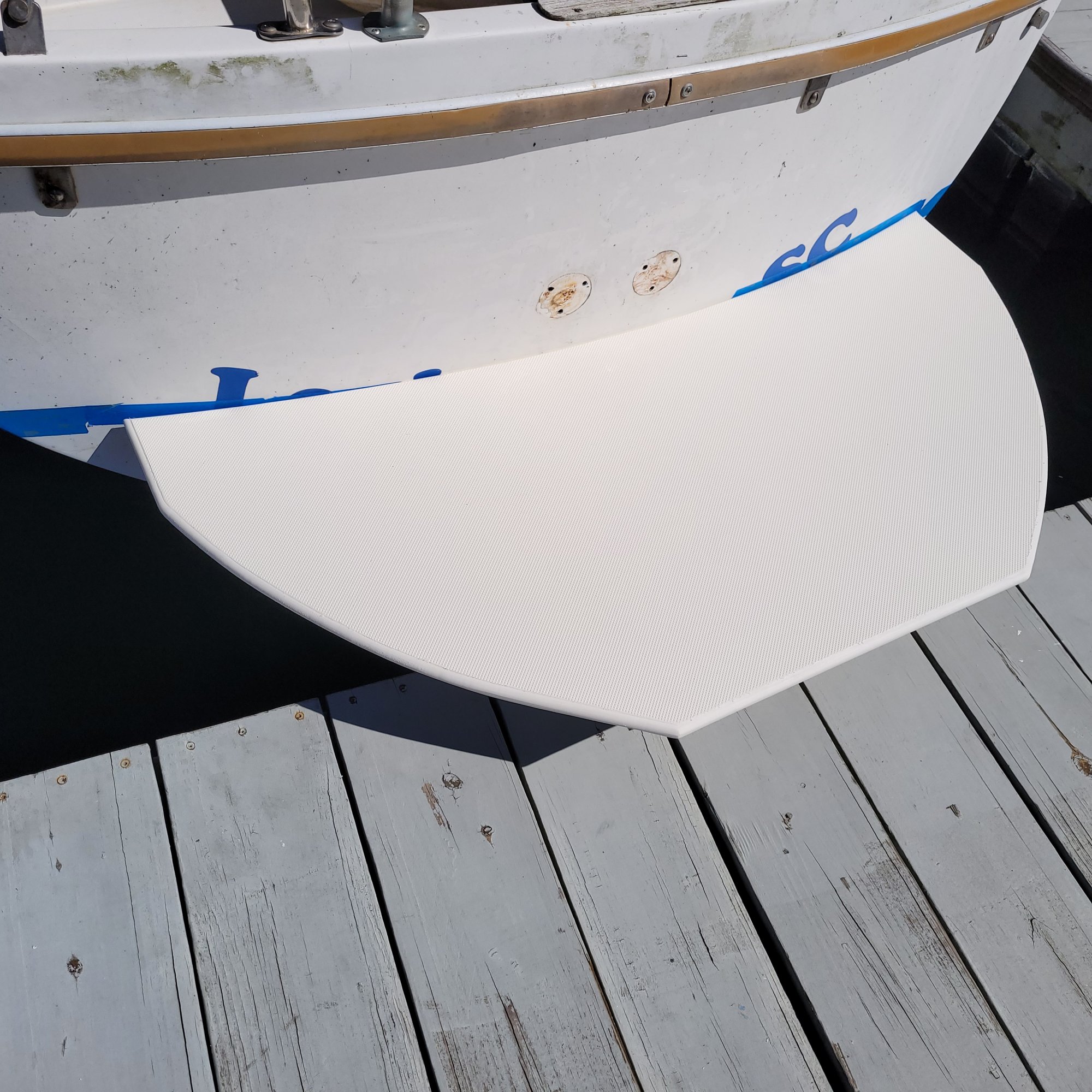

Removed stock stern swim ladder. Designed & Added a Swim platform from 3/4 Non-skid starboard, with attached ladder under. Was a pain to get the curves right But finished product is gorgeous. The thick starboard is hard to source in large sizes. Found a set of mounting brackets that allow the whole platform to be removeable with just two quick lock pins. Got their last set for $125, Pandemic prices pushed same part to $175 a month later.

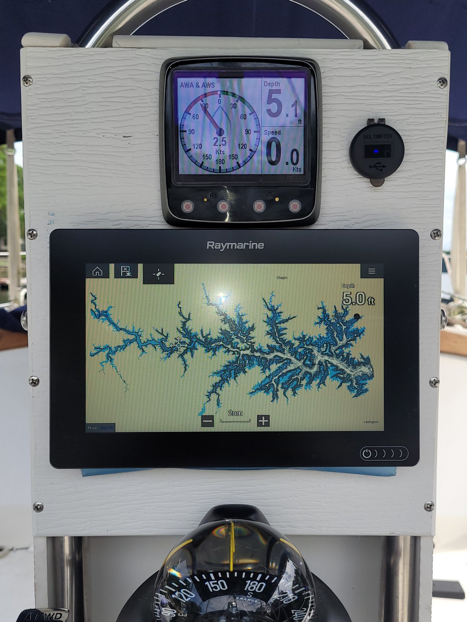

Installed a new Raymarine Axiom 9 Touchscreen display. Integrated seamlessly with my old Raymarine autopilot, and it bluetooths to my phone and the stereo. (And to the radio I think, have not tested this yet.) Was on sale for 1/2 price on July 4th. I love a deal!
Screen is huge by comparison to previous Dragonfly5, big enough to actually see my course, and touch screen makes it a snap to set a course or marks, or a starting line. Even has the polars programmed in for many boats(just not the C30 TR) I have to figure out what is the closest thing in the Raymarine database to mine, Have not put much thought into that yet.
Calculates your laylines based on Instrument data your polars and your course marks, and updates with wind shifts. Pretty Fine!
Had to figure out how to design an instrument cabinet since I could not source one that fit like I wanted. Used a 2'x4' 0.375" PVC material I've used in the past as a starboard substitute. It worked quite well, bent@ 90 degree angles beautifully so there are no visible fasters on 3 sides. Axiom 9000 and my existing Raymarine autopilot control both fit in there, added a pair of USB chargers and a battery monitor as an after thought, which turned out quite well. 99% done with that, I have to refab a top cover plate to get tighter clearances around the binnacle rail, tricky to shape around that curved rail, but I don't want a lot of sealant or gaps for the mud daubers to find their way into. Had to learn some new tricks, seems the usual process.
