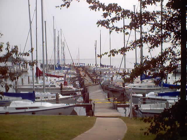

Lots of damage at HHN docks. Cythere and Jambalaya are fine, as are all the boats on the hard. (Assuming the Cythere traveller was lashed to boom midair and is not storm damage.) More details plus pictures and my conclusions when I get home, as this is stop at sisters computer.

Matt, the traveller mentioned was on Jambalaya, sorry for the confusion. I think HHN was damaged so much because its exposed to the Bay to the east. Normally storms come from the NE or S, but this was east across the Bay and with a large storm surge. Docked boats were broadside to the wind and waves. The outer end of the pier was not the place to be.

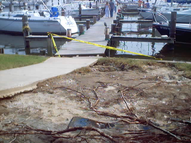

Look closely
I was looking at the seawall where the pier and concrete sidewalk was, thinking the erosion from the surge was bad there. Someone came along and explained that a boat had been thrown up on shore and thrashed around there. He then pointed out the pivot point of the keel just peeking out of the ground where it had been driven into the earth.

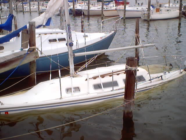

Some more info on Herrington Harbour... The marina is still without power or phones (as of last night.) Unfortunately, my boat was out on the end of one of the destroyed piers in the photos. Most of my damage came from the only other boat that was out there still (in the next slip.) Some of the problems also arose due to the small number of cleats on the smaller boats(like mine.) It's hard to get multiple lines on those small cleats. I finished my preps the night before the storm and was by myself. The marina folks came by and suggested I move to another slip up at the other end of the marina. I would have loved to do that, but they wouldn't help (they were obviously very busy,) and I wasn't about to undo all the work I had just done to prepare. All in all, the boat survived, but is now in the need of some repairs and possibly a new motor (we'll see what the insurance folks have to say.) The marina has some big tough choices to make now about rebuilding.

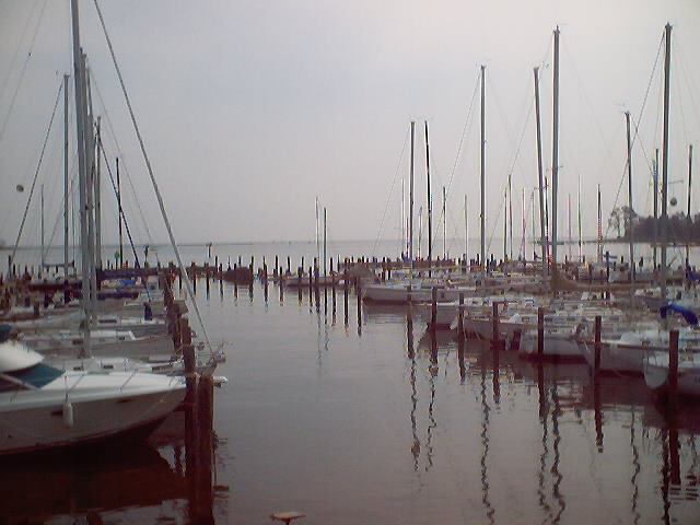

The damage to piers A, B and C and the boats on them came from the waves rolling in from the Chesapeake Bay. The piers are normally somewhat protected by a long breakwater. The storm surge was above the breakwater and that allowed the waves to go directly at the piers. There was breaking surf at the marina. With the breakwater, conditions would have been rough - without it they were impossible. On Wednesday, I moved my boat from B dock to a sheltered slip up the creek. She survived without a scratch!
