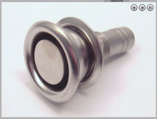

Not to highjack this thread but I though this would be a good place to ask, the pictured is the through hull vent that I have, I suspect given the odors we are experiencing that the vent is some how plugged, I have attempted to push water from a garden hose through this from the outside and it appeared that no water was penetrating the vent. In looking at this from the inside the boat it appears like a difficult task to even get to the hose connection at the vent fitting. Would putting a shop vacuum on this fitting possibly clear any obstruction? is there going to be more effort required? It doesn't appear that the center of the vent is removable and I would imagine that the vent only allow (1)-way floe so as to prevent inbound flooding.

Peggie,
I feared that you would recommend this change but what is the particular reason as to why one would need to change to that style vent?
Are there any precautions required to prevent down flooding other than ensuring it is higher than the steepest lean angle?

Your vent line should already have an upward loop to prevent water from getting though.
Dec 2, 1997
8,915
- - LIttle Rock
It's completely open, allowing the exchange air needed to create an aerobic environment in the tank--that is, provided the vent line is short and relatively straight--and also allows you to prevent vent blockages by making it possible to stick a hose nozzle up against it to back flush the line.
Only if you want odor out the vent...
So-called "vent" thru-hulls are designed to keep sea water out of fuel and fresh water tanks...very important for fuel and water, but hardly necessary for sewage tanks. Water splashing against the thru-hull won't put enough water into it to notice...but you don't want to heel enough to "submarine" any vent thru-hull for very long. I advise people who plan to do any serious blue water cruising that could put 'em into conditions that keep their decks awash for days or even hours to put a shut-off valve on the holding tank vent line. They'll be flushing directly overboard at sea, so it won't matter if the vent is closed...and they can open the vent again when conditions improve.

If you have the mushroom type thruhull, you can stick a hose against it (if you have a large TH, you can stick a hose INTO it. With the deck plate off, you should be able to see the level come up the pipe and know the vent is clear. Go with the mushroom and a larger vent hose, and know that's one less potential problem.
