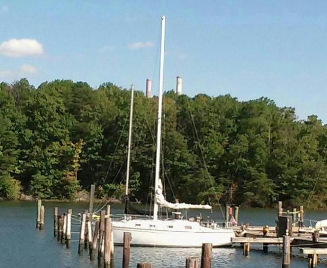

My cherubini is now in the water but my question is she has been in water last two months and its about a 1.5 hr drive, when j got to her, the bilge was full of water,float up and bilge not pumping of particular concern was the bilge water had plenty of silt in it. Recently had a water heater(bubbler) put down near boat( maybe thats doing the stirring of silt, but where would all that water be coming in from?
