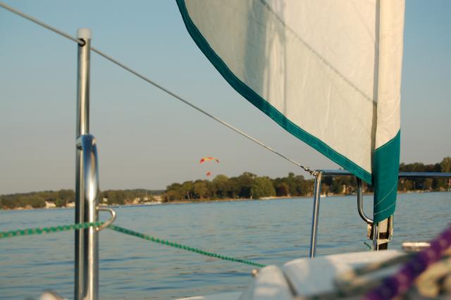

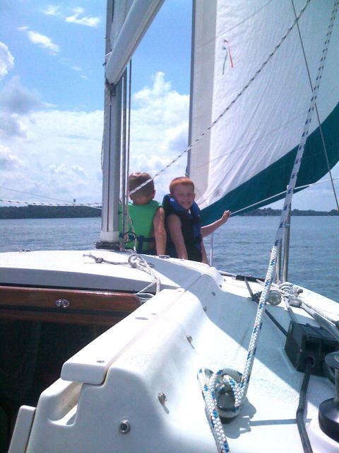

I purchased a 1995 H23.5, this is our first year sailing. I remember the previous owner stating that he sent the original jib to SailCare for cleaning, and may have received a different sail in return (mistakenly). I think it is not right for the H23.5 because:
1) When Furled, the jib lines are wrapped well above 1/3rd of the way up from the deck, at least twice as high as other furled jibs I see in the Marina.
2) When unfurled, the clew is really high, and the foot angles upward from the tack at the bottom of the roller furler.
3) When unfurled, the foot is clear of the life lines
4) It is apparent that the blocks on deck the Jib sheets run through are not in the correct position (too far forward), we just end up pulling straight down on the clew.
It obviously is over a 100% headsail, could it be the right sail installed incorrectly on the roller furler? Do I need to rig differently? I would like to avoid buying a new headsail, but want to have the our boat correctly outfitted. I have attached two photo's to provide an idea of how the sail looks. Any opinion/advice is welcome.

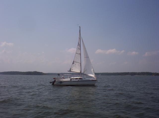

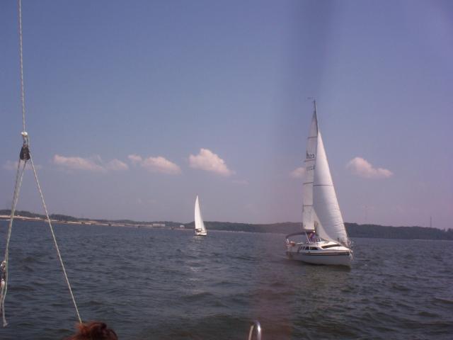

here are pictures of my boat. I have a working jib. I've not seen a 23.5 with a larger jib out. It looks like it's set up similar to my boat (working jib). If you zoom in on the pics you'll see that my working jibs clew is above the life lines as well. I wish I had the roller furling that would make life easier.
I've posted messages asking about buying a larger headsail but most of my replies say I shouldn't. I followed the advise from others and worked with my standing rigging (tunned it). I've only sailed 3 times since and I do think I got better performance.

It difficult to tell from your pics but I think your sail is installed the correct side up. It is more than likely the wrong sail for your boat. The higher the clew location the further back the sheeting block needs to be located.
Check out the used sail lofts online. This is your best option for a low cost sail.

You could ask Hunters for the correct sail dimensions and lay yours out on a lawn and measure it.
Also many (most?) reputable sailmakers will have the dimensions and if you are nice to them they would possibly give you the sizes.
Or have you got a picture of your boat whilst beating which shows the whole sail. If the luff length is okay and the fairleads will adjust to give the right lead then you could be good to go already.

Thanks for the links, I have saved them for reference. I think you are right, it may just not be the right headsail for my boat.
Donalex,
Practical advice, I will measure and compare against what I can find from sailmakers or Hunter. With the Minnesota season coming to a close, I will have all winter to plan the fix for the 2011 season!
