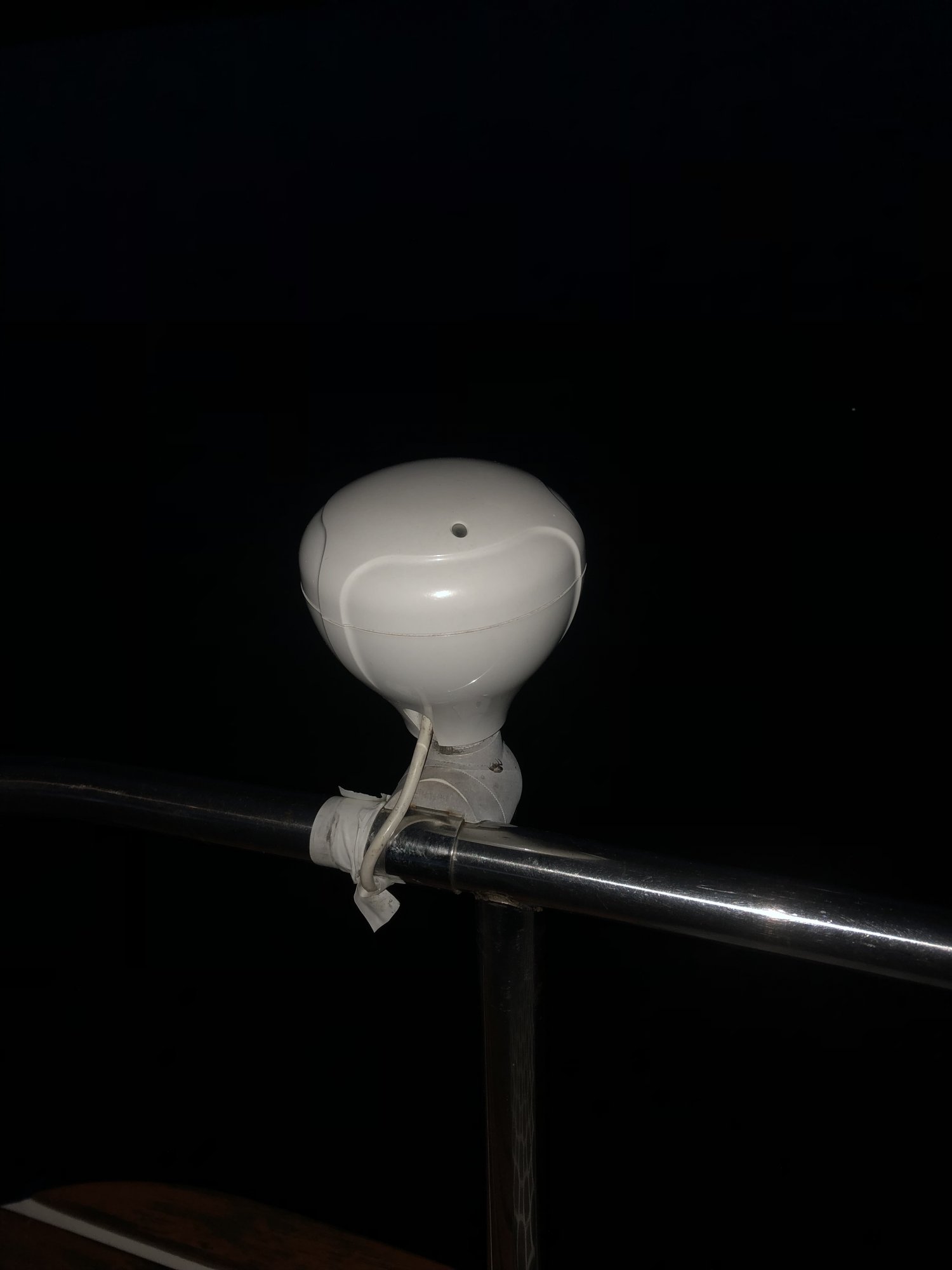

So I noticed this receiver flashing while we’re anchored. The chart plotter is off at the panel, so is this drawing power????

InterestingMaybe it has a battery operated indicator light to tell you it isn't getting power.

Wild guess... it is your VHF radio, GPS antennae.so is this drawing power?

And I lost a full night's sleep worrying about thisFull disclosure my bad. Breaker got inadvertently turned on.
ThanksThere are passive and active GPS antennas. The active GPS antenna incorporates a powered amplifier to boost the signal strength before it reaches the navigation unit. It is used in longer antenna cable run applications and when a faster signal acquisition and a faster response in position updating is desired like in a fast powerboat. It is likely your antenna has an indicator LED signal to let you know the amplifier is On and drawing power from your batteries.
